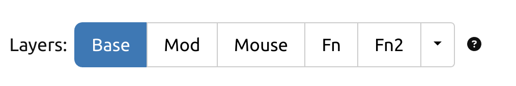

We better clarify layer semantics in Agent because people consistently wonder about them.
Notice the added ā?ā icon. What should its tooltip contain? My proposal:
- The Base layer is active by default and canāt be deleted.
- Mod, Mouse, Fn, Fn2, Fn3, Fn4, Fn5 are regular layers that their layer switch actions can activate.
- Shift, Control, Alt, Super are modifier layers that the related modifier keys can activate.
Looks good, guys? Iām summoning @maexxx because heās been helpful in phrasing. Everyone else is welcome to suggest.

If you think the tooltip is fine, we can implement it as it is.
You have been granted a wish ![]()
Mouse, Mod, or Fn. When such a layer is active, keys produce what is defined on that layer.Shift+a normally produces an uppercase A, but can be overridden by defining a different action on the Shift layer.) Keys left unconfigured on a modifier layer revert to their regular base layer + modifier action.Feel free to take/modify/mangle my proposal.
