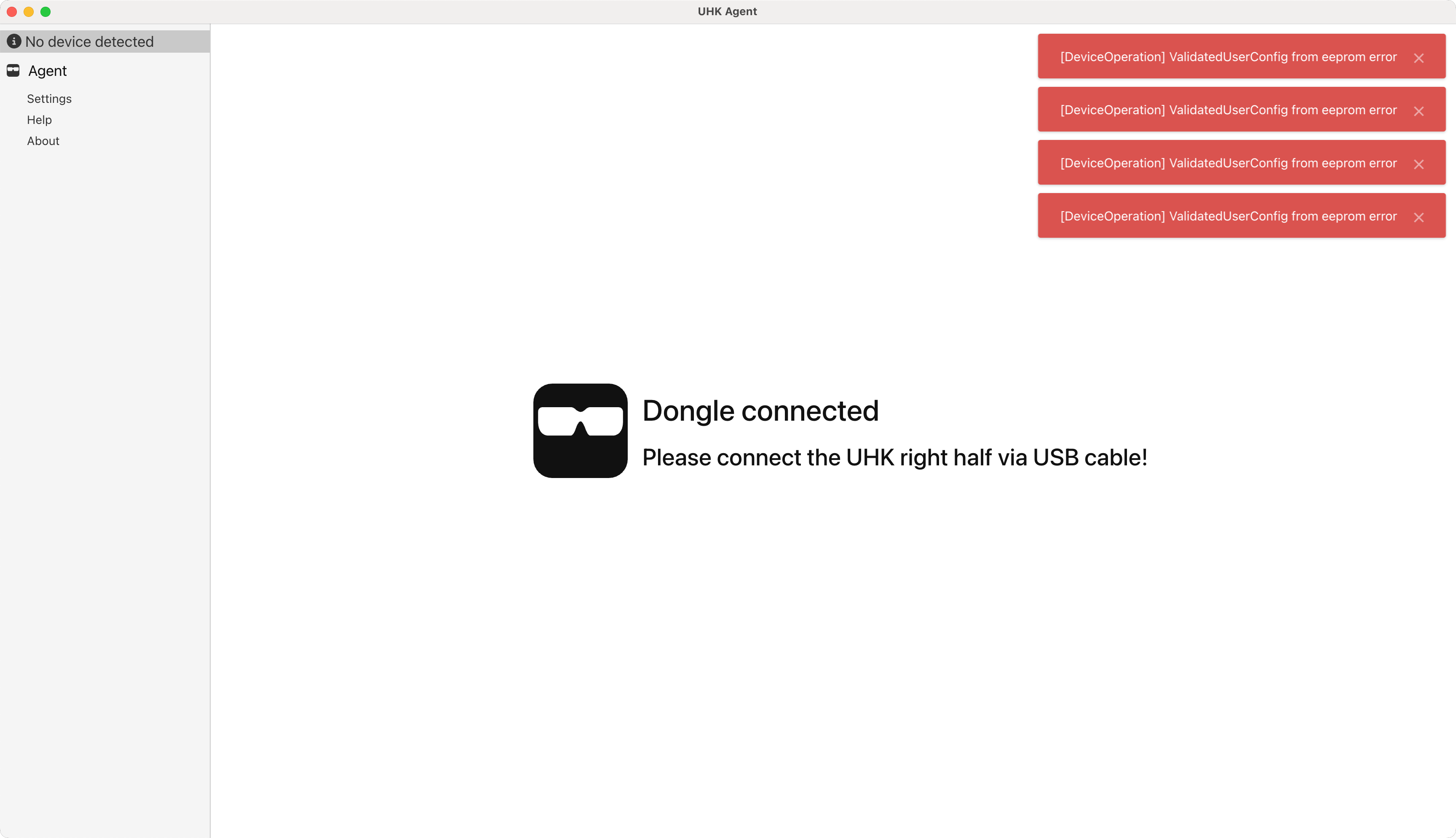

The knowledgebase has directions: https://ultimatehackingkeyboard.com/manuals/dongle
Ah the nuance is the cable needs to be connected first or else the message does not appear. Prompted to connect the cable and then nothing about pairing.
Maybe try closing Agent, temporarily disconnect the bridge cable (just in case, so not to possibly trigger the lag issue), and reset the right half. Then reconnect the bridge cable & open Agent to see if that helps.
Thanks for hte usggestion but hta tid dno towkr, i tonly caused hte miixn gup o fcharacthers
And now the same message typed from a different keyboarad.
“Thanks for the suggestion but that did not work, it only caused the mixing up of characters”

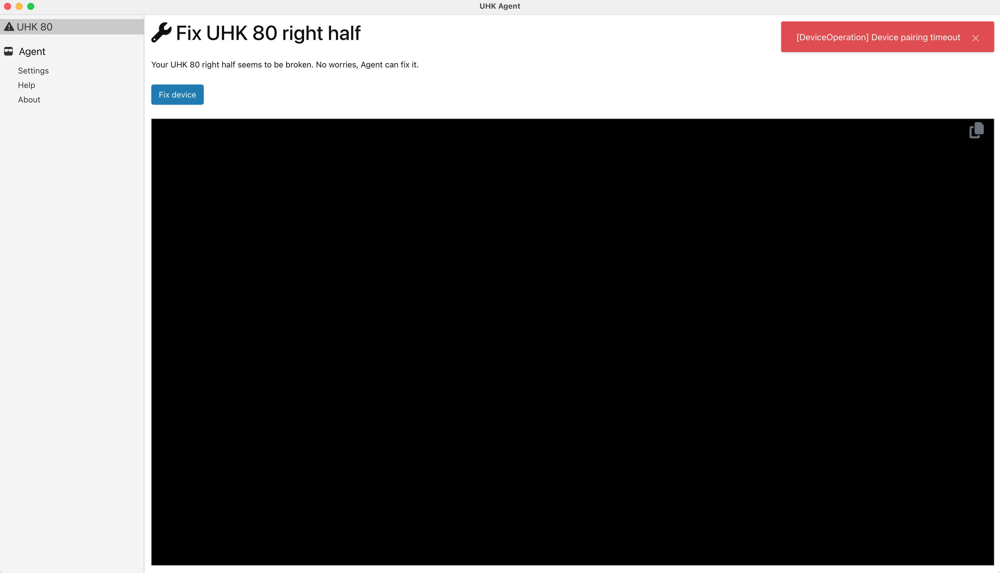

And the UHK80 is now is a tailspin of errors.

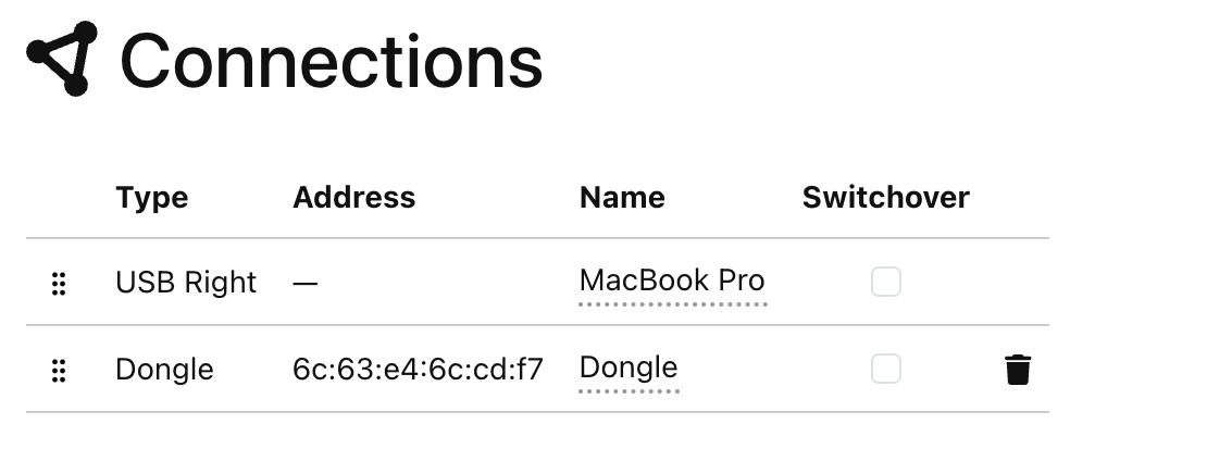

Dongle now pairs and does not go into a loop of failures. But it also does nothing. When I have it paired to the dongle, no BT and no USB cable, I get no inputs from the keyboard at all. Connection on the keyboard says Dongle but no inputs.
Is there an additional step?
