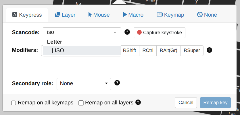

Well, that key definitely has a scancode and you can map that scancode via Agent.
My guess is it is the iso key:
Maybe I should have started with this !!
I cannot test it now because I don’t have the UHK here. Sorry for all that noise if the solution is THAT simple, and thank you for your time, that’s very apprciated
ok then, everything works perfectly using “ISO” scancodes
thanks for your help again
