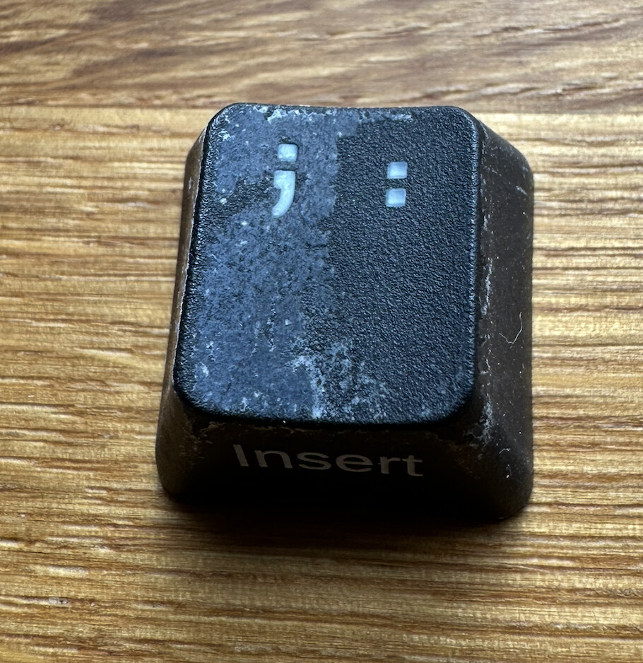

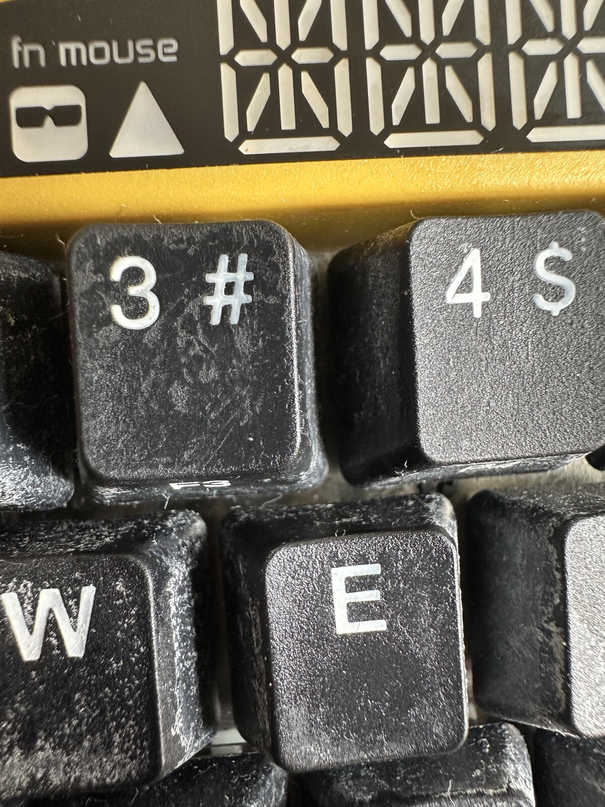

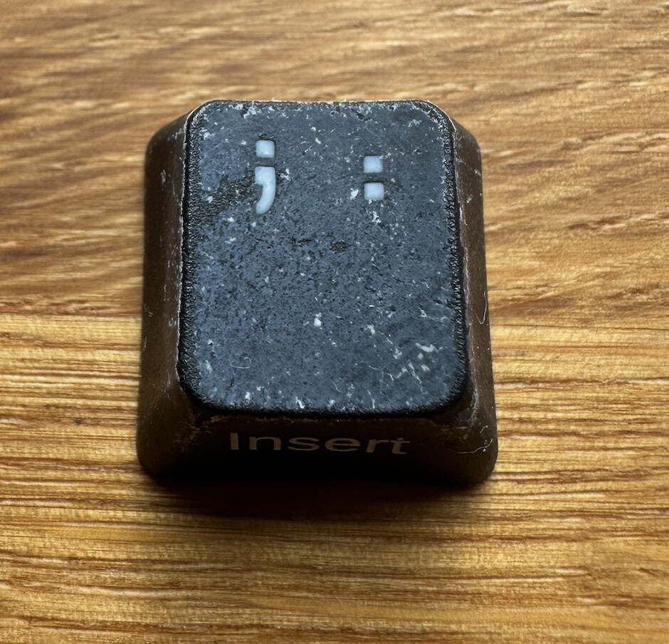

I’m a little bit ashamed to say its the first time I completely removed the keycaps of my UHK60v1 for a clean and run into the same problem like shown in the pictures. I had the same observations as @DavidHarkness there. The surface of the keycaps looked really smooth. After cleaning it is more rough and looks exactly like the keycluster keycaps.
I don’t belive it is scale buildup or anything like that. I used osmosis water with the same problem. The residue is not reacting to acid and cleaning it “polishes” the surface, but it doesn’t matter if its microfiber with water or acid.
The residue is more “rubbery” and “gooey”. Since it sits in between the rough surface, it is hart to clean and only scratching it with my fingernail seems to really work.

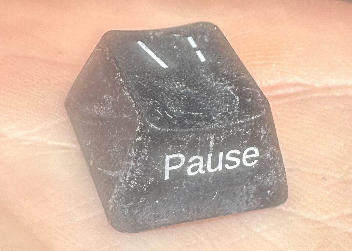

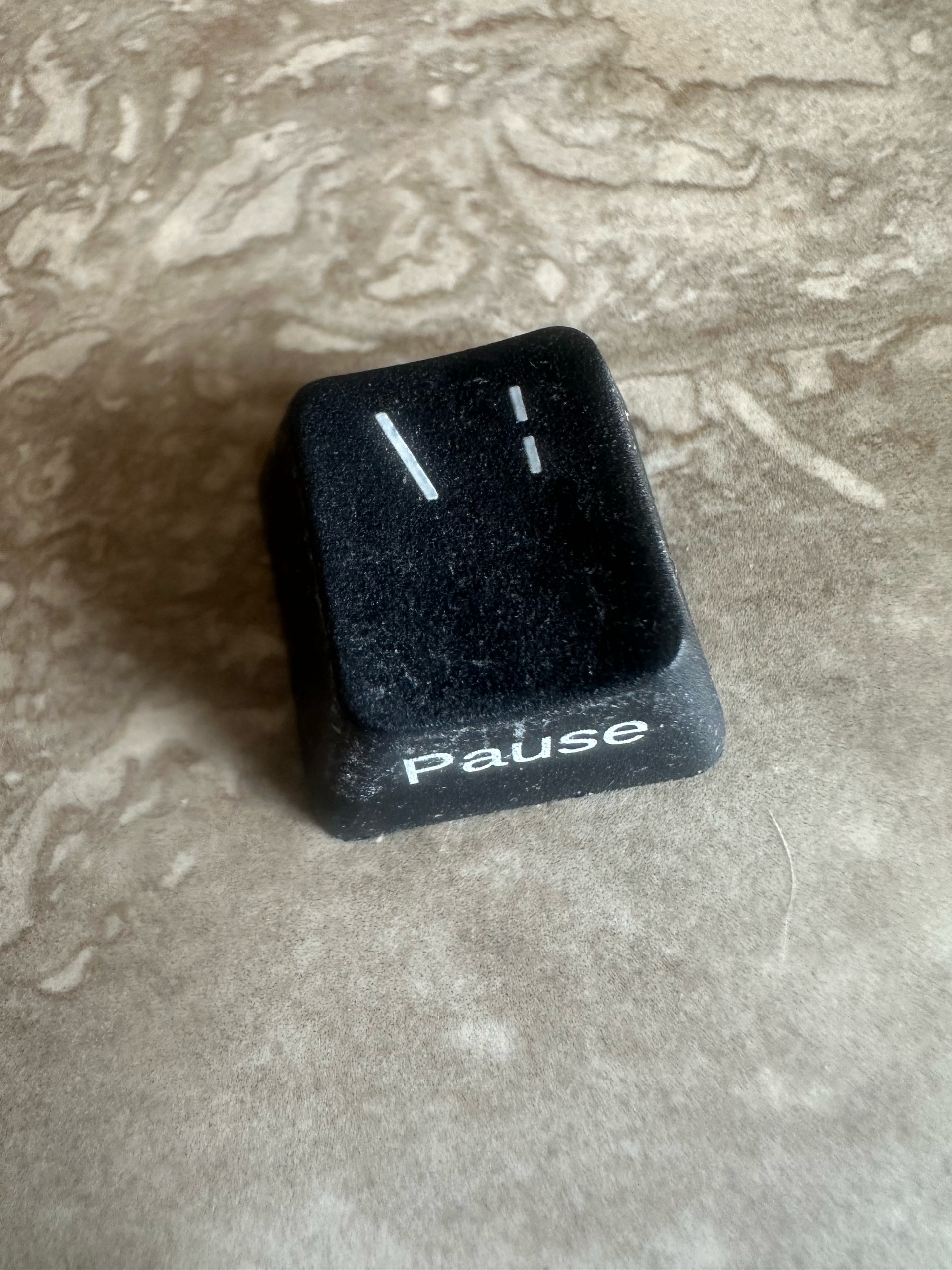

The tip with the oil:
This only works if the residue is left “intact” on the keys. It polishes it, makes it “shiny”, but doesn’t “cleanup” the keycap. This will be a easier solution for ruined keys, but beware: if you have cleaned one keycap already, scratched the residue, etc. polishing it with oil won’t lead to “clean” results.
Cleaning with only warm water and a little bit of dishsoap:
Rubbing the residue of on one half:
“Smoothing” with oil, slight improvement but will whiten again if the oil is rubbed of by using the key:

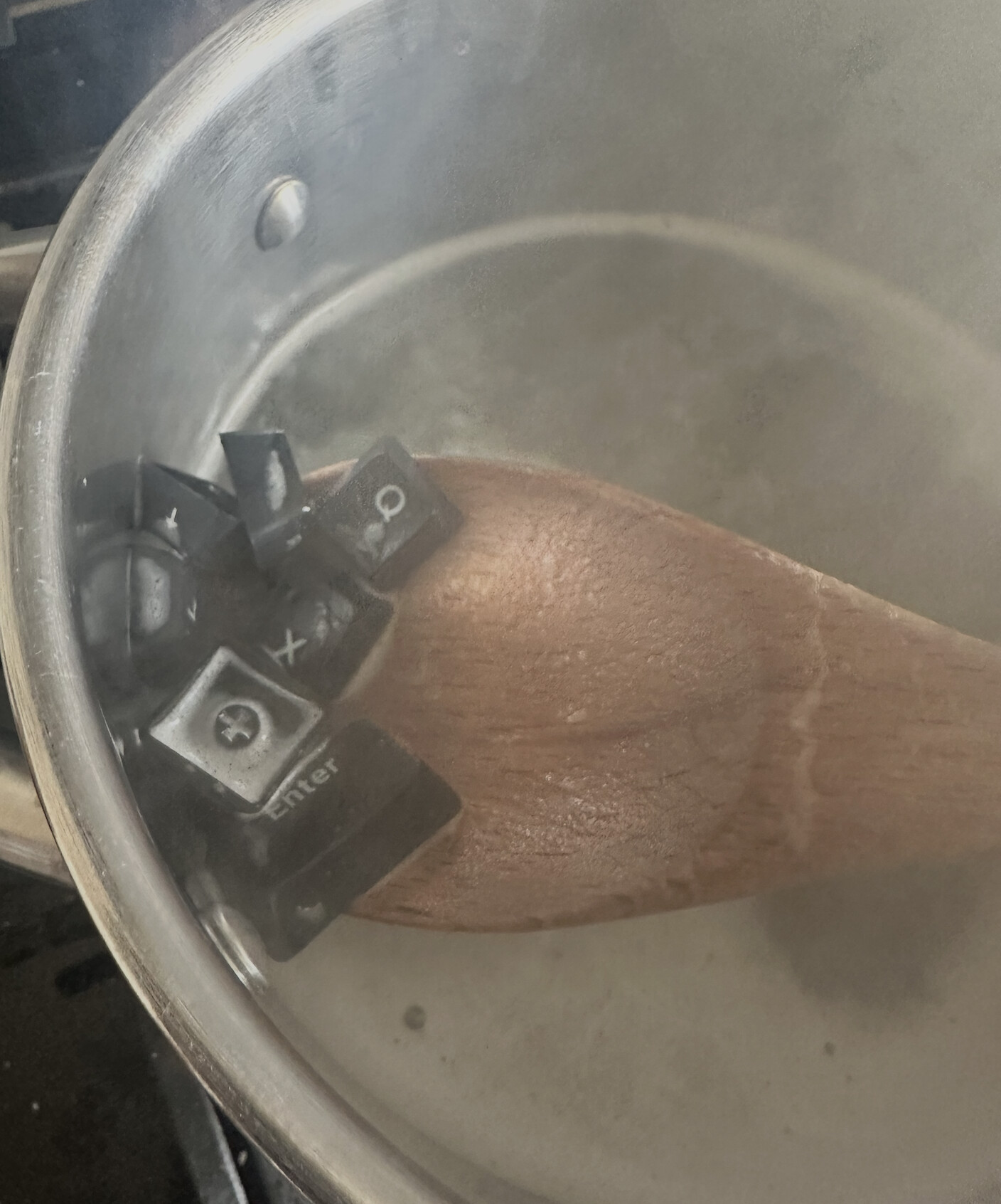

Supplied for your entertainment, don’t try this. 100 C should be fine for PBT, still it didn’t help with the residue, so no need to try this :slight_smile:

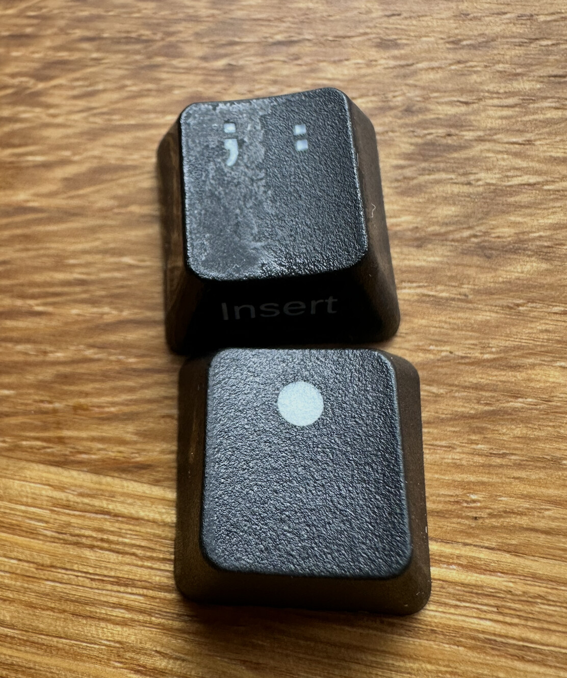

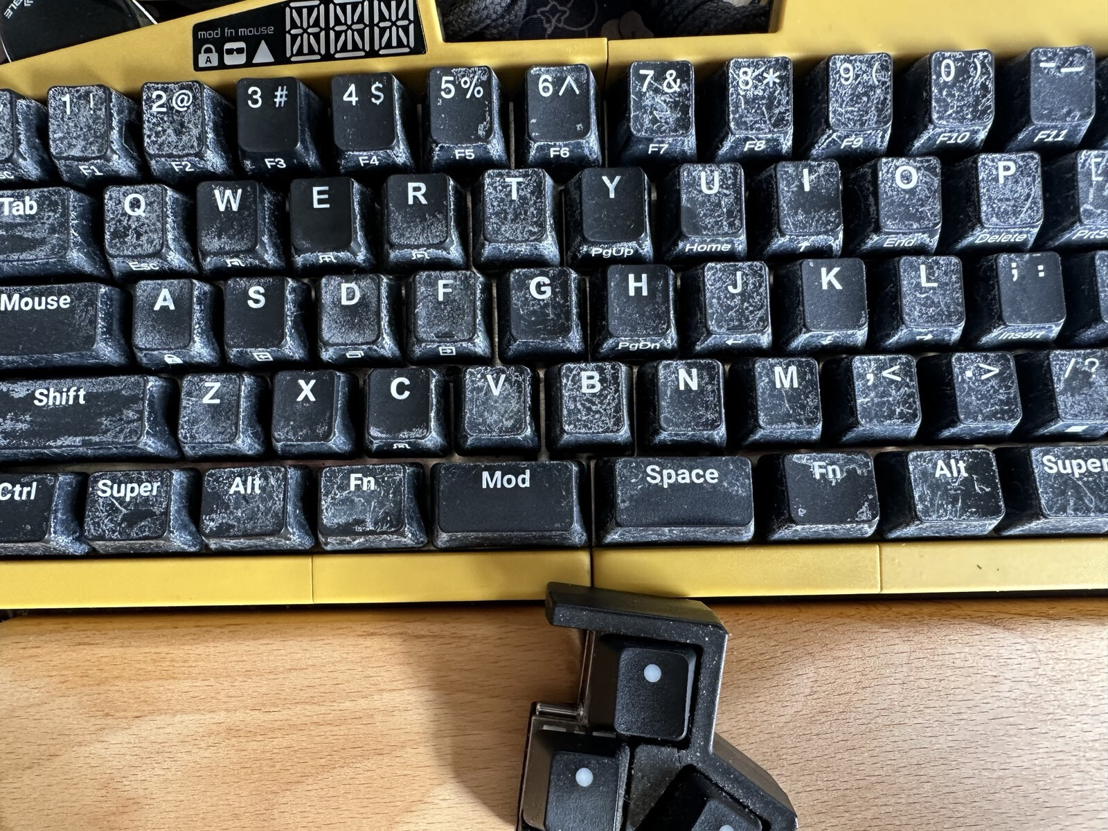

This is the current state of my keycaps after trying to clean with water + soap.
Note the Keycluster keys.
Note Keys 3 and 4.

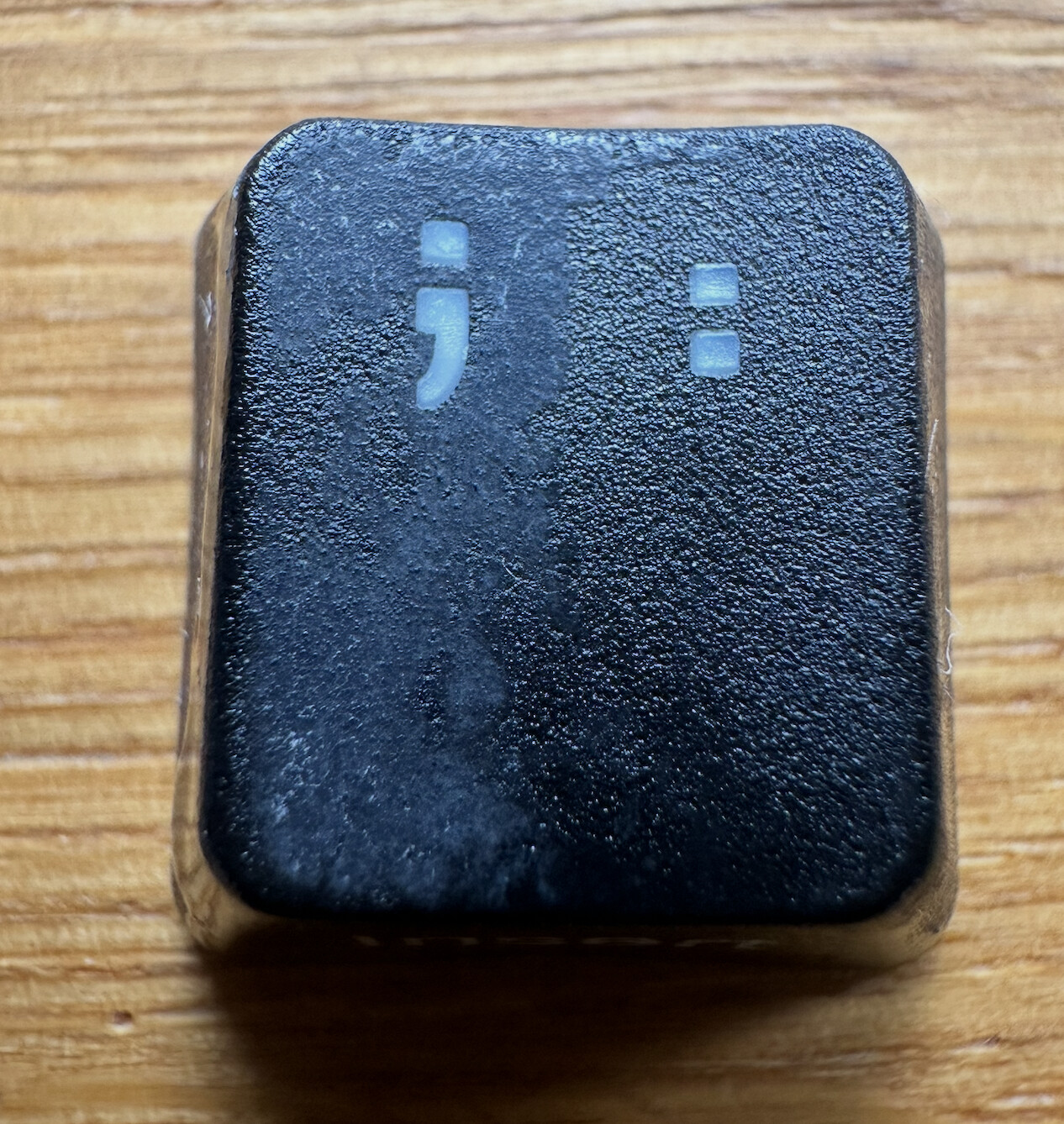

4 is cleaned completely. 3 is “polished” with vegetable oil. Looks fine in this picture, with a slightly other angel you can still see the residue left.

This is one of the keys which I just “polished”, not scrubbing that residue off:
Same treatment again. Distilled water makes no difference:
This does not happen to the keycluster keys, which I’ve included for reference (the one with the dot).
Never removed all the keys completely for cleaning, so I’m confident this is nothing I accidently applied. Used microfiber cloth and water for that anyway…

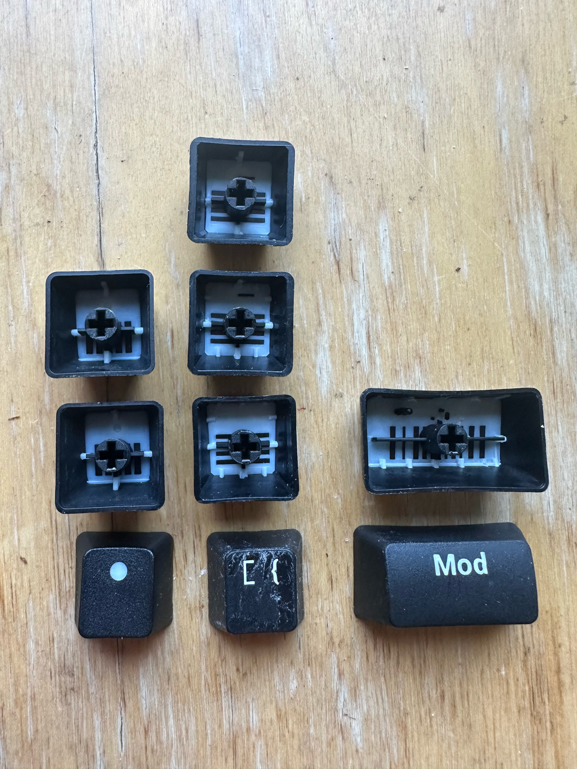

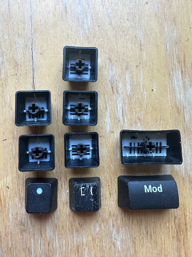

The keycaps in your last post look like ABS keycaps. Can you take a shot of their backs? That’d surely confirm. The UHK 60 v2 should have shipped only with PBT keycaps, so I don’t understand the discrepancy.
In the first photo of your Problems with cleaning my UHK - #30 by echox post, there are two keycaps below each other. Both of them seem to be PBT keycaps. Please also take a photo of their backs.
Left: Keycluster
Middle: “O”, “P”, “;”, [“
Right: “Space,”, “Mod”
This looked double shot injection molded to me and at least they feel different to my regular ABS keycaps.
This photo of yours seems to feature ABS keycaps, and you mentioned your “UHK 60 v1” which we provided with ABS keycaps.
Keycaps with the stripe pattern on their backs are clearly PBT.
Sorry for the hassle, but we need to confirm whether ABS, PBT, or both keycap types are affected because they’re completely different in this respect.
