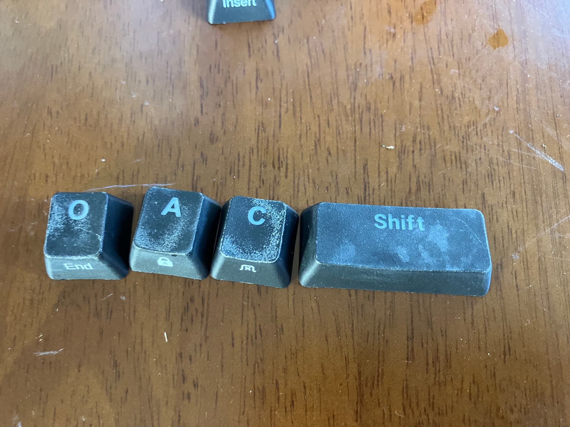

I am cleaning my UHK roughly every 8 - 12 weeks by removing all key caps blowing all dust and hair out and cleaning my key caps with soapwater and a sponge.
However on some of my key caps there is a tiny layer of dirt which I can scratch with my fingernail (and a lot of force) but will not go away by soapwater.
Here is a picture after the cleaning process with soapwater (for some reason this layer turns white after it)
When I use Isopropanol after it, it gets better:
But I can not get them 100% clean.
As for cleaning the palm rest, I have a similar issue but I only used soapwater (no Isopropanol) and I guess I should follow this guide: Palm rest refurbishment guide - Ultimate Hacking Keyboard by polising it and add a new layer of lacquer.
However I was wondering what lacquer to use (or maybe some wood oil is better?) to get a more robust skin for my palm rests.

1, Basically, when we use soft soap to clean the keycaps, this coating will not be removed. So using some engine oil or sticky lubricant (with soft fabric) to wipe the keycaps can probably make them look new again.
2, As for cleaning the palm rest, the manufacturer of the wooden parts suggests car spray: lacquer spray that is normally used for cars.

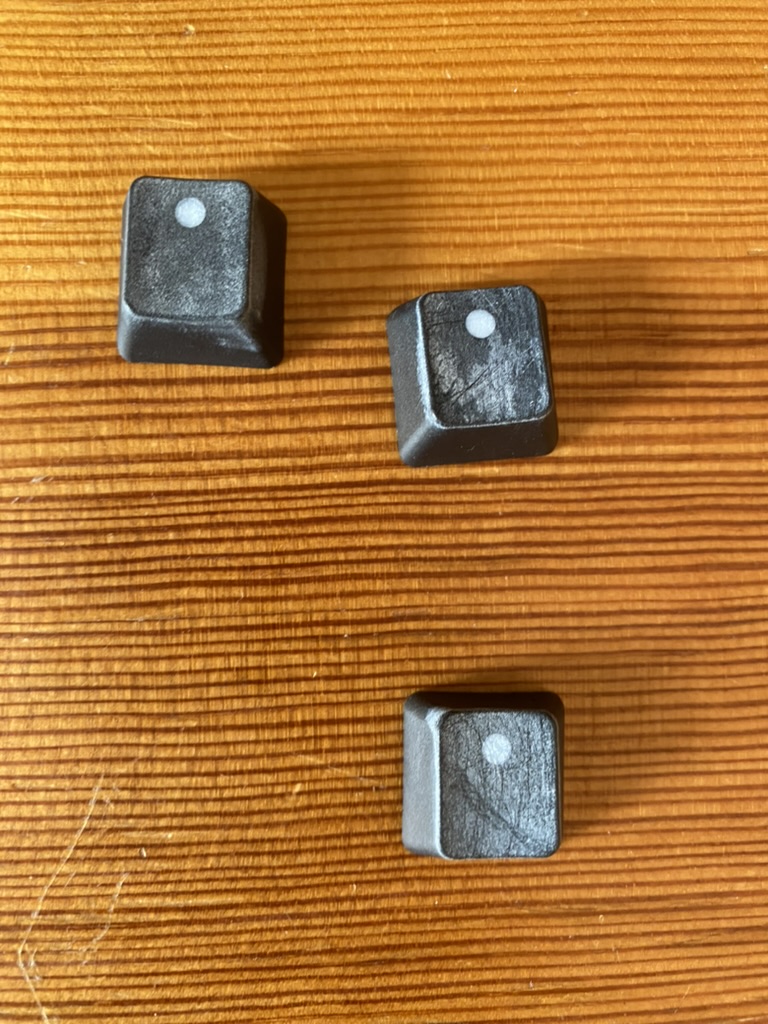

Oh, your photo reminds me the days I ruined mine…
I soaked them in a soap water for a few hours and washed with a water. That white residue came up. So I repeated the process and it got even more contrast. I tried a toothbrush. I used an IPA solution and an ultrasonic bath, but every time I washed the keys the white residue just got… whiter and brighter. As the last resort I tried some dental liquid in an ultrasonic bath, and after that (that was like 5th washing or even more) the keys got even worse.
I ordered a new set. Now I am not sure how to clean them, and the date approaches.
Thanks a lot for the pictures and warning.

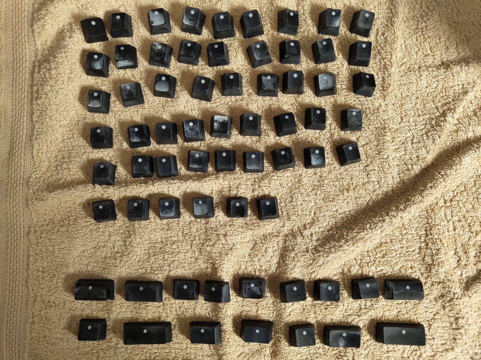

I ran into this same problem yesterday after I washed my UHK60v2 keycaps along with another set of keycaps from another keyboard using denture cleaning tabs. After the first round of cleaning some of the keycaps got this white powdery coating. It was uneven and blotchy and wasn’t present on all keycaps so I thought that maybe I didn’t soak them long enough or the other something dissolved from the other set and got stuck on UHK caps and I just didn’t rinse them properly.
Second time around I only washed the UHK keycaps. The other set seemed fine and clean and even if they needed another round I would’ve washed them separately. This time I let them soak overnight, thoroughly rinsed them and set them on a towel to dry. And when they started drying the same coating started to appear, this time on more keys and even more prominent than first time around. Attached some pictures I took after the keycaps had dried a bit after the second washing.
About the suggestion. I really need to ask: are you serious? Because using engine oil on your keycaps sounds like one of those “advices” around the internet, like “use acetone to clean some plastic parts” or “if your phone gets wet just put it in a microwave for a few minutes”.
And if you are serious, then what kind of engine oil? There are like a million different kinds and since I don’t have a car, a scooter, a lawn mover, or anything else that runs using an internal combustion engine I don’t have any engine oil lying around. I also don’t know what you mean by sticky lubricant. And isn’t using any oil or lubricant counter productive when trying to clean the keycaps?
Besides being vexed about this, I’m a bit disappointed. The built quality on my UHK60v2 and all the accessories (palm rests, modules, riser) have been top notch. Never in a million years would I have guessed that the PBT keycaps wouldn’t tolerate being cleaned with denture tabs. It seems to be the most common way of cleaning keycaps of mechanical keyboards, even more popular than using dish/hand soap in warm water.

Isn’t that actually scale on the keycaps from the water?
Scale from the water is probably it. These are the caps from my Dec 7, 2020 UHK v2, order #8374. I soaked for 10min in tap water and dish soap and got the white coating even after scrubbing with a microfiber cloth. After realizing it could be mineral buildup from the water, I soaked a microfiber cloth with 5% acidity vinegar and scrubbed each key, and here are the results.
They look even better in person. Conclusion: only soak in distilled water!
