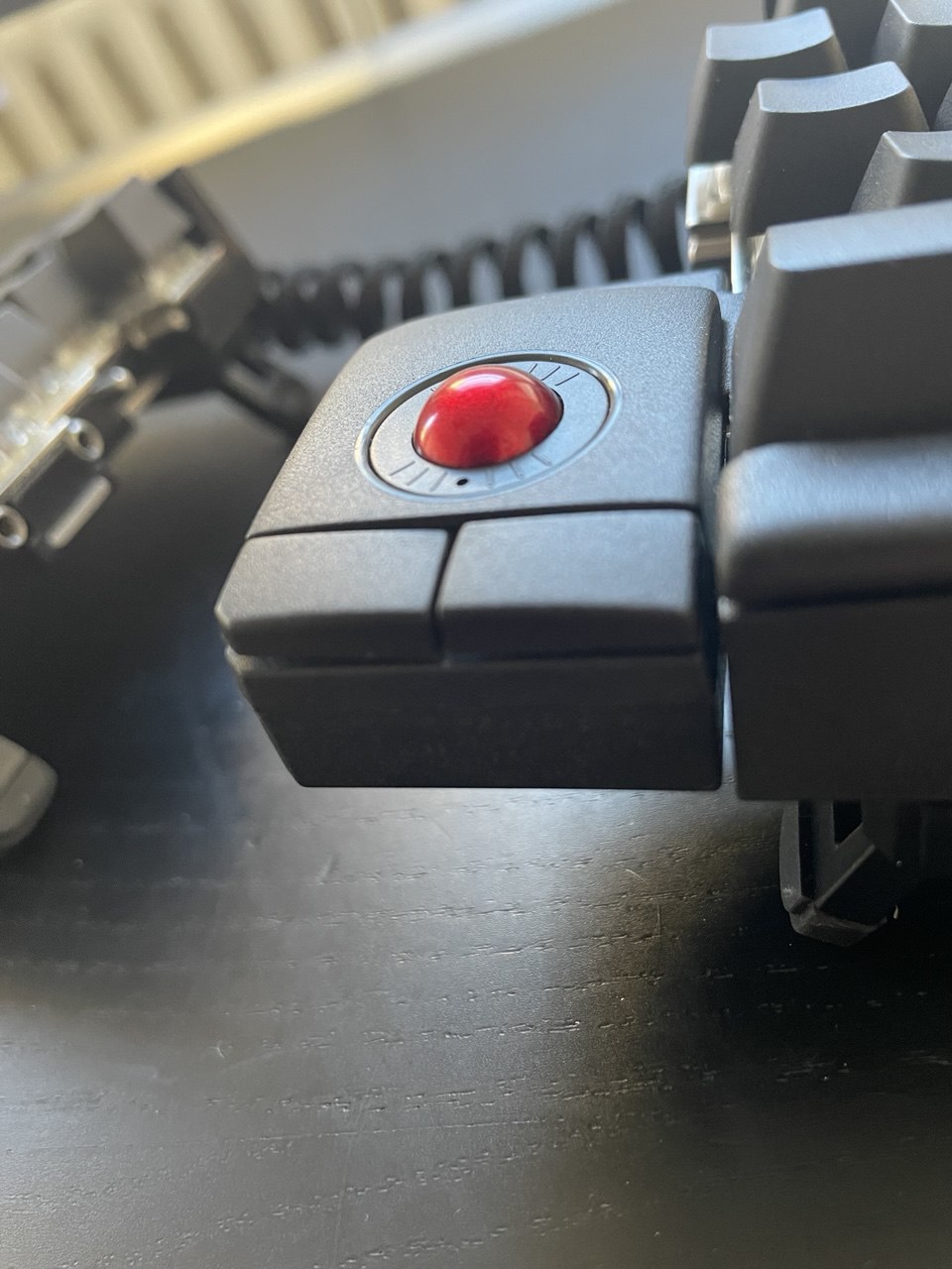

i just received my uhk60 and noticed some issue in the trackball module.
The left switch is not working nicely when pressing on the right side of the button and also the button is slightly uneven.

That’s definitely not normal.
I don’t remember internal assembly of the buttons, but either there is something broken, or just not snapped in place.
Feel free to disassemble the module and look at it yourself :wink: .

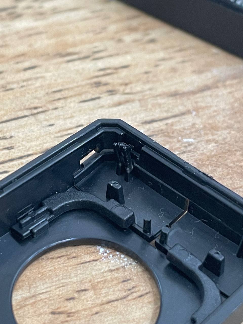

I can’t reply with a photo but that part is bended and almost broken.

@silicium Sorry for the issue! We’ll follow up on your email and send a new part.
