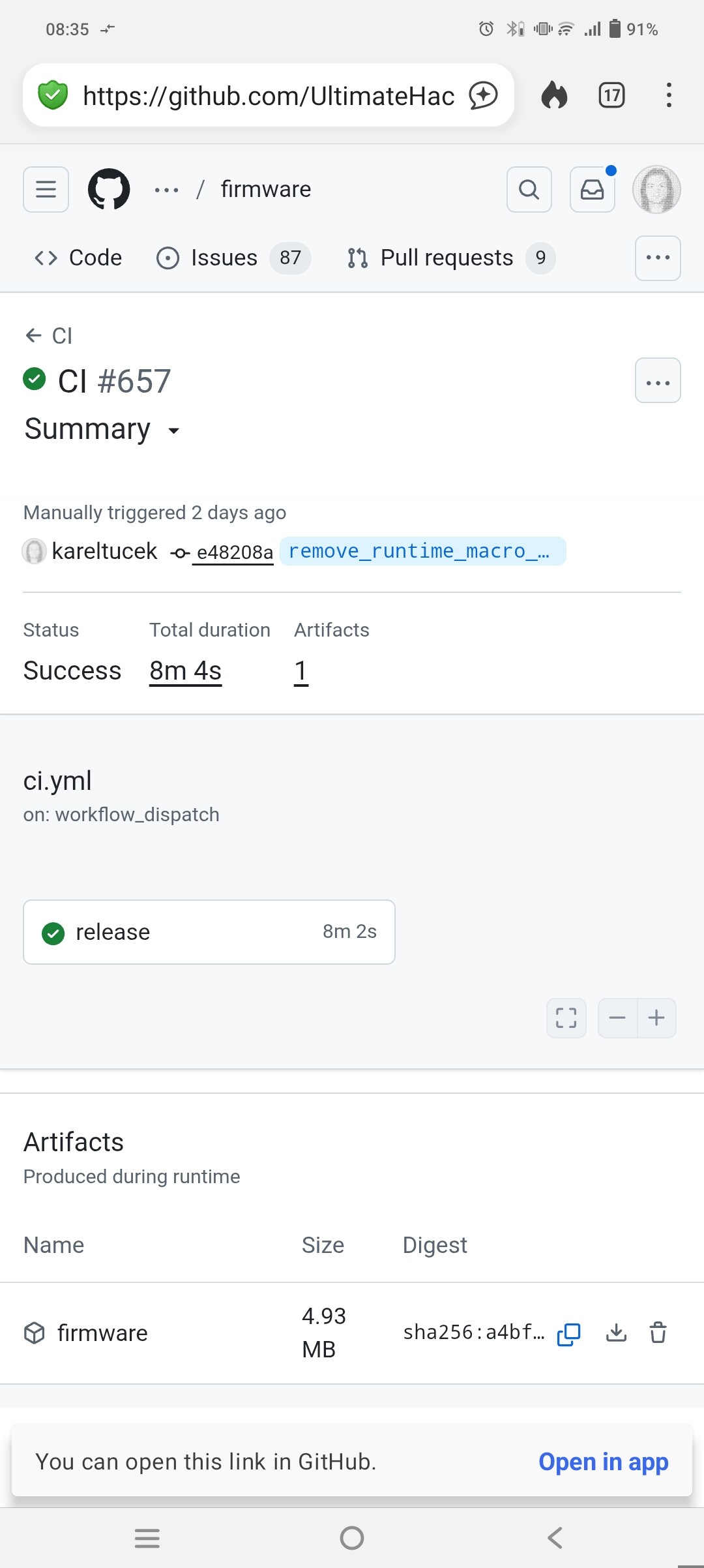

The link above leads to a ci action that contains the precompiled artifact :wink:

“leads to a ci action” .. I don’t use github, so I’m not sure what that means. There isn’t anything downloadable from that page that I can see, nor in any of the other links leading from that page, which is why I compiled my own.

See firmware at the bottom of the screen:
Okay, that link only shows up if you are logged into github. Good to know.

By the way, even with that direct link you need to be logged into github - it just sends a 404 otherwise.
