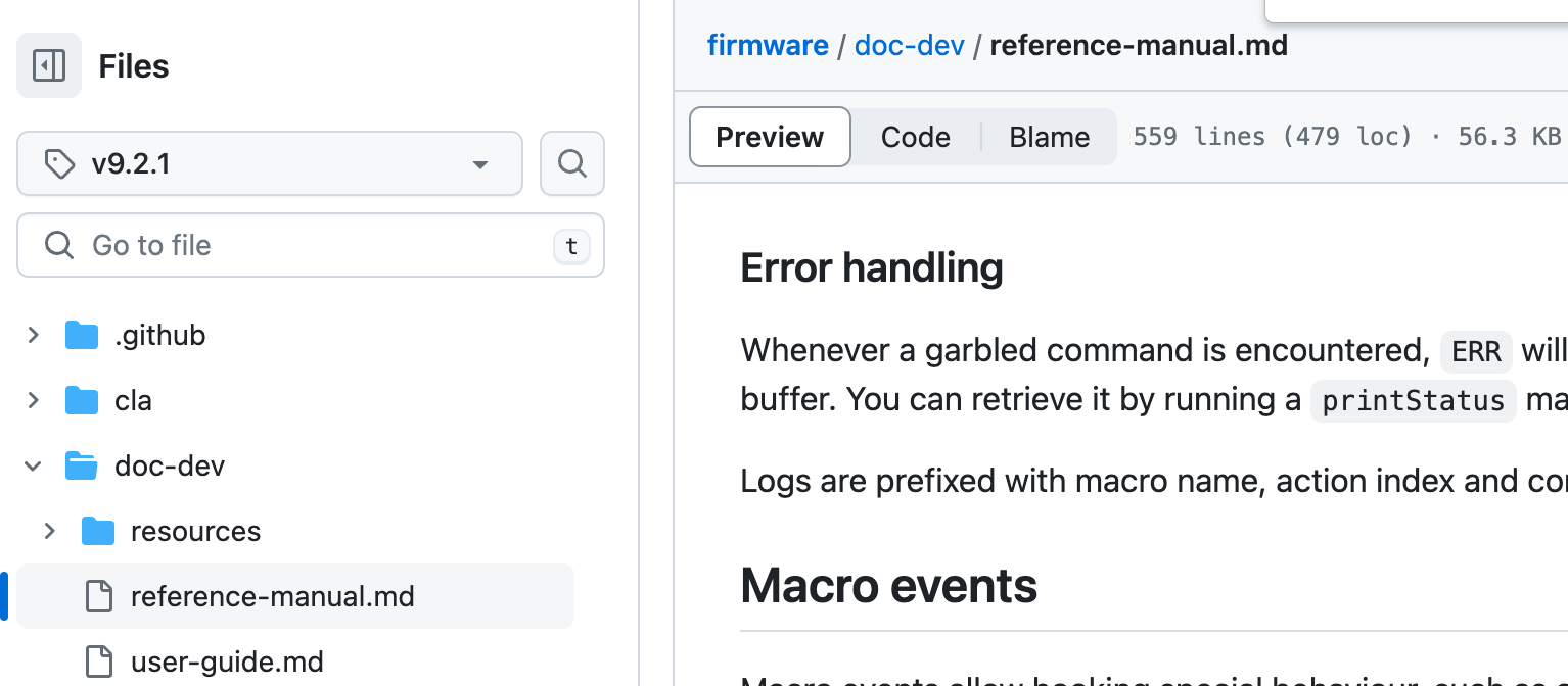

I just realised why I couldn’t find the information I needed… massive user error, i was looking at the wrong docs…
I’m having a few issues with my syntax for if statements. I cannot figure out from the (correct) documents what I am doing wrong here. Any ideas please?
