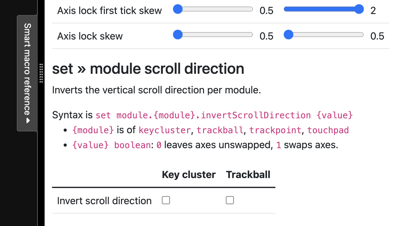

Siebjee
November 27, 2023, 7:57am
7
The docs inside the agent currently do not show this new change either.
There it still persists as invertScrollDirection see screenshot.
Agent Version: 3.2.1
Firmware Version: 4.2.0
UHK v1 & UHK v2
mlac
November 27, 2023, 9:11pm
8
Thanks for the heads-up! Just fixed it, and the fix will be live in Agent via the next firmware version.
