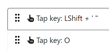

I have mapped the following macro to a layer-key:
The oneShot layer is defined with oneShot holdLayer fn2. That works in general, but not consistent.
When I hold down the layer-shift key and press my o-key repeatedly the output should be ΓΆΓΆΓΆΓΆΓΆΓΆΓΆΓΆΓΆΓΆβ¦, but what I get is something like ΓΆΓΆooooΓΆΓΆo"βooββoΓΆΓΆoooββoooΓΆβ¦ This is not a repeatable pattern, trying it a second time gives: ΓΆooooΓΆΓΆoooββoββoooββooββooββoΓΆoβ"oΓΆooβ¦
