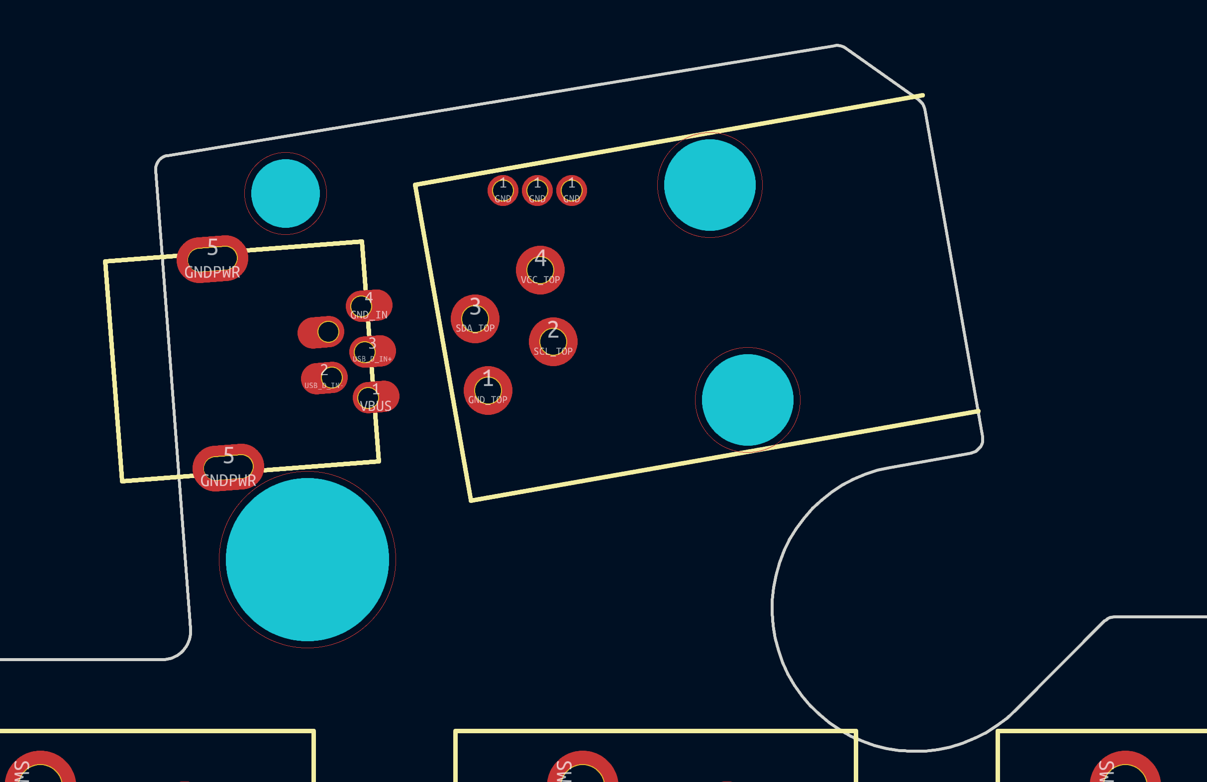

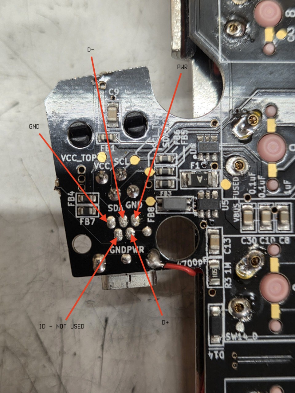

Hi there, I am trying to give my old trusty UHK v1 a much needed refreshment by adding a usb c port. Would anyone be able to confirm the pinout for gnd, pwr, d- and d+. I think it should go this way but would rather confirm before frying my board. I am confident with GND and PWR but have my doubts about D+

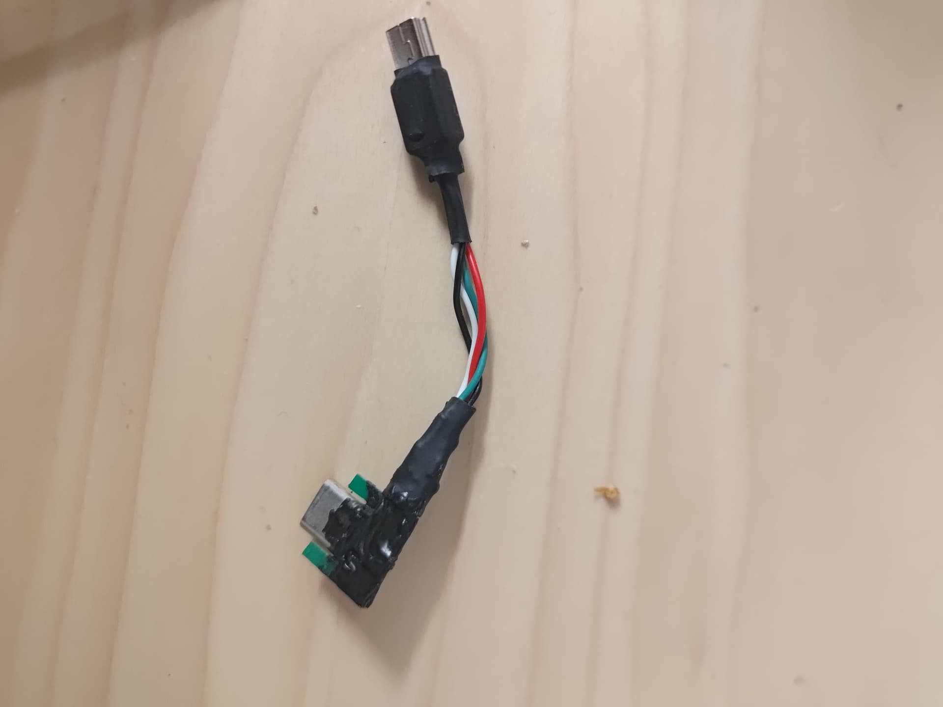

If I may recommend a different approach:
C to mini adapter can be used to also move the port somewhere more convenient.
Remember to add the proper pull-down resistors as per the USB specs.

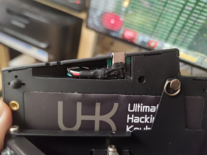

That’s a really nice hack, @Firngrod! Almost looks like a “USB-C upgrade kit” could be built for easy installation in existing UHK60v1.
thanks! exactly what i was looking for!
