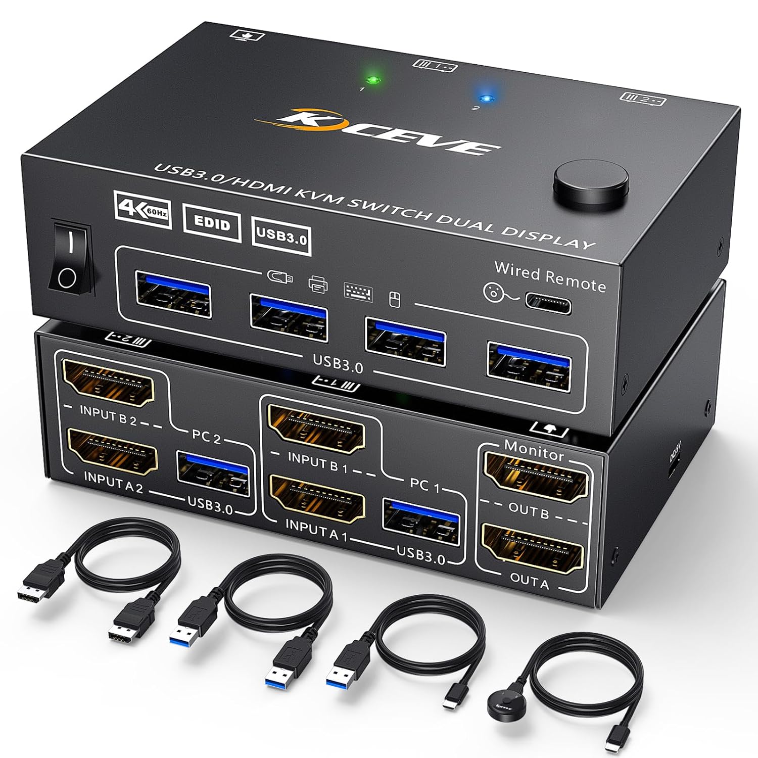

After successful upgrade to 17.0.0, my UHK60 v1 is not recognized on Windows, USB Composite Device fails with “This device cannot start. (Code 10) A device which does not exist was specified”. It works when connected directly to the laptop.
KVM is a simple device, manufactured by AIMOS, produced by Shenzhen Qiyu Technology Co., Ltd. in China, can’t find AIMOS website, not compatible with NKRO (firmware/issues/536), but it was working fine till before the firmware upgrade. I have submitted just now the KVM in the KVM switch compatibility - Ultimate Hacking Keyboard list.

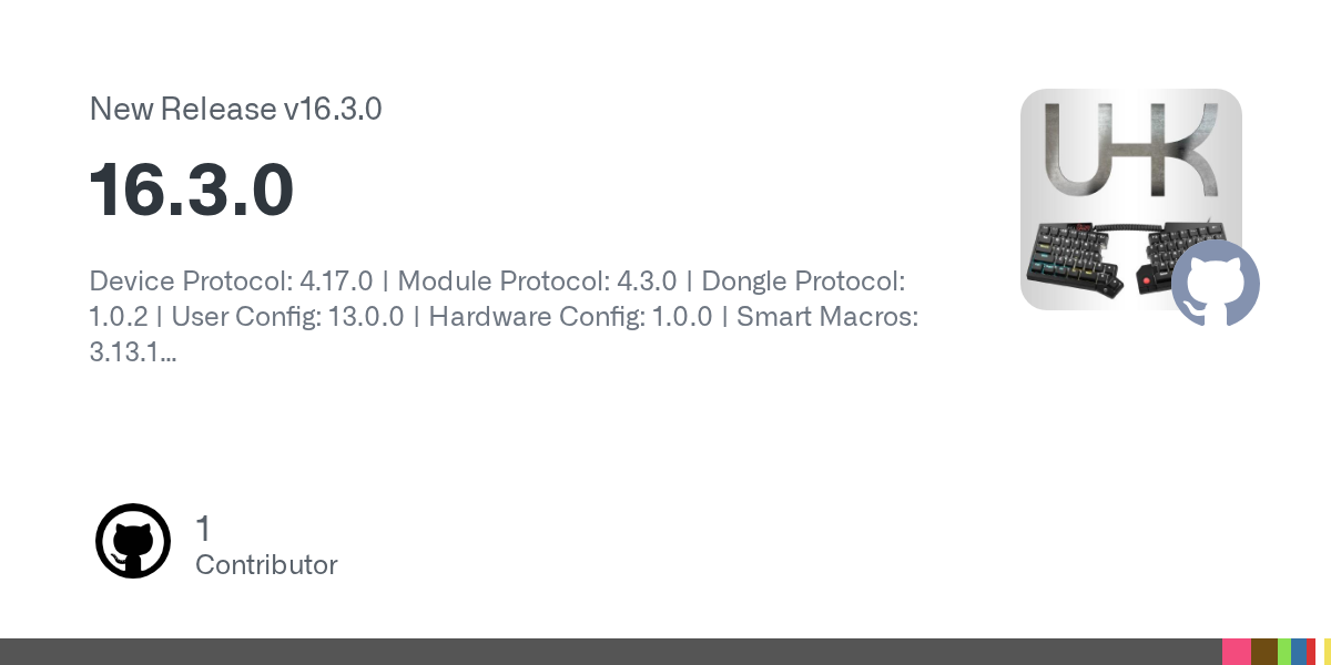

Can you test 16.3.0 please?
Hi! I got a different KVM and it works. I got the Aten CS22HF from the KVM compatibility list. Thanks for responding, @kareltucek.
