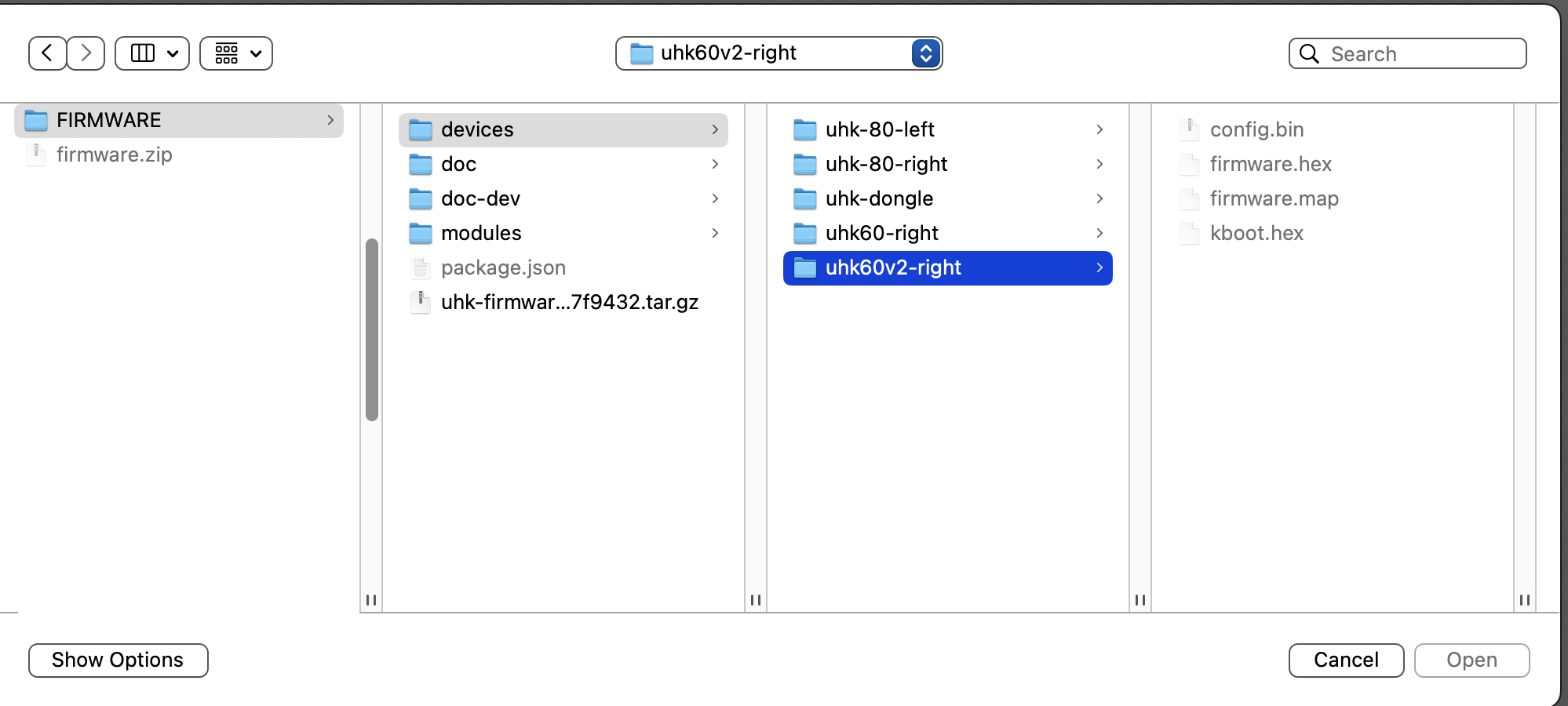

Okay, now I don’t see how to flash the file. I unzip the zip file, and I click the button to choose a file to flash, but I don’t see one I can select. I have looked through the entire file structure in the zip file. I see the devices/uhk60v2-right directory, but I can’t select any of those files.

By unzipping you should get a .tar.gz file.
Only by another decompression you get directory structure.
Yeah, apparently macOS sees the tarball and unarchives it. I have the modules directory, and when I choose “flash from file” I do not see any file in the directory structure that I can select. Here’s what I see – note that all files are grayed out. This is true for every file in the directory structure.
Okay, I just figured it out.
I need to choose the tgz file and flash that. macOS, trying to be helpful, unarchived that.
I got it now. Thanks.
