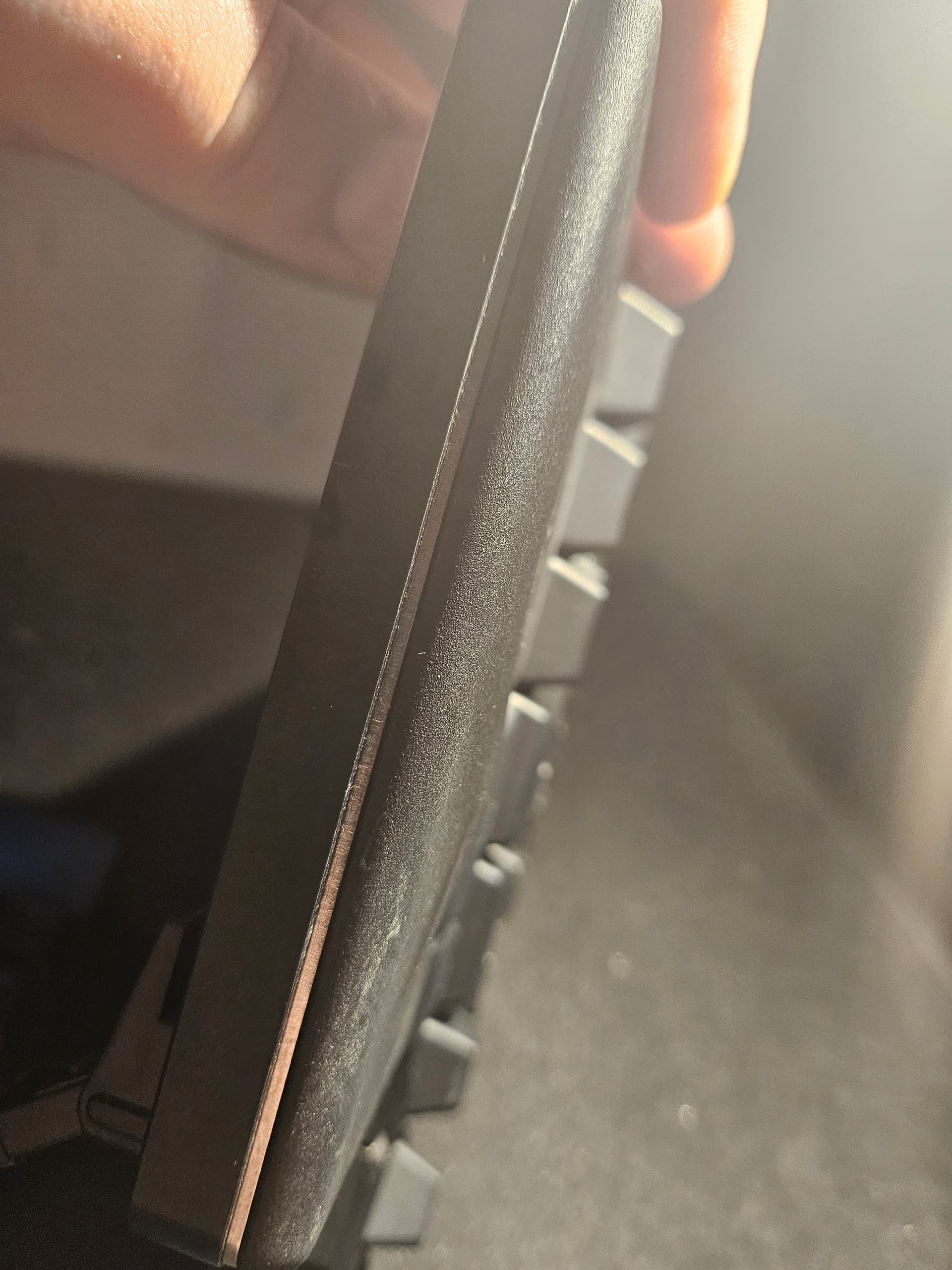

Does anybody have issues with the rubber wrist rest provided with and attached to the UHK 80 “bubbling up”? By this I mean there is a bubble that has formed on the right wrist rest of my UHK 80 which is quite uncomfortable and distracting. I’m not sure if just replacing the rest’s pad will work as I assume it has something to do with the material and as far as I can tell there isn’t another material to choose from (a nice wood or plastic version would be appreciated, but I understand the difficulties of designing these especially with the other issues currently plaguing the UHK 80 that the amazing team is currently resolving).
Have you tried peeling the whole rubber pad off and re-seating it? It is not glued, you can just lift it off the keyboard, and put it back on again. Does that change the “bubble”?
I’m also having this issue, and no, it does not. It looks and feels like it has warped.

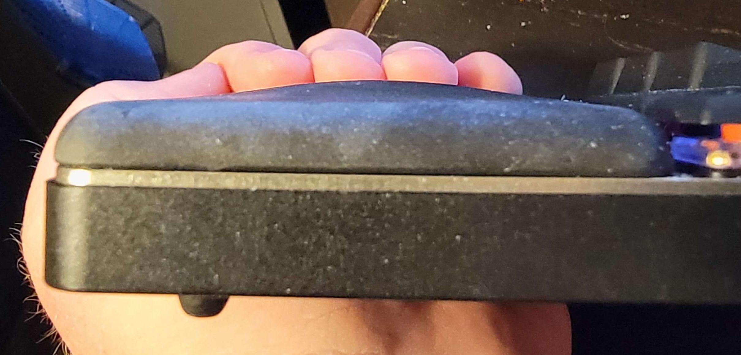

Most areas of the palm rest are firm and flat, but the places where my palms physically rest have started to elevate, and I can push them down with my finger and feel an air bubble below those areas. They’re small now and not any kind of annoyance yet.
I’ve only had my UHK80 for 2 weeks, so it’s a bit disappointing to see this problem start to develop already. It’s happening on both sides.

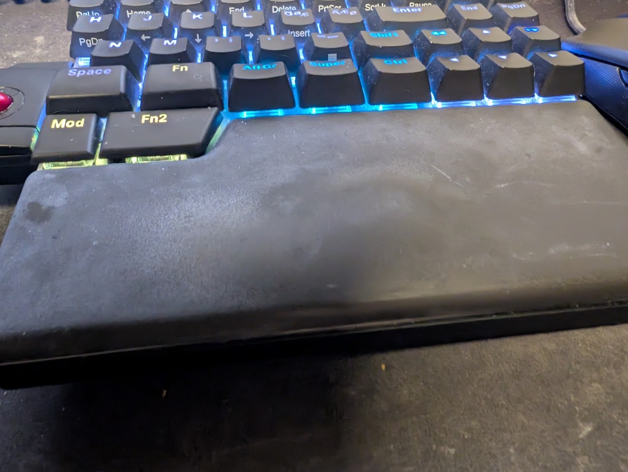

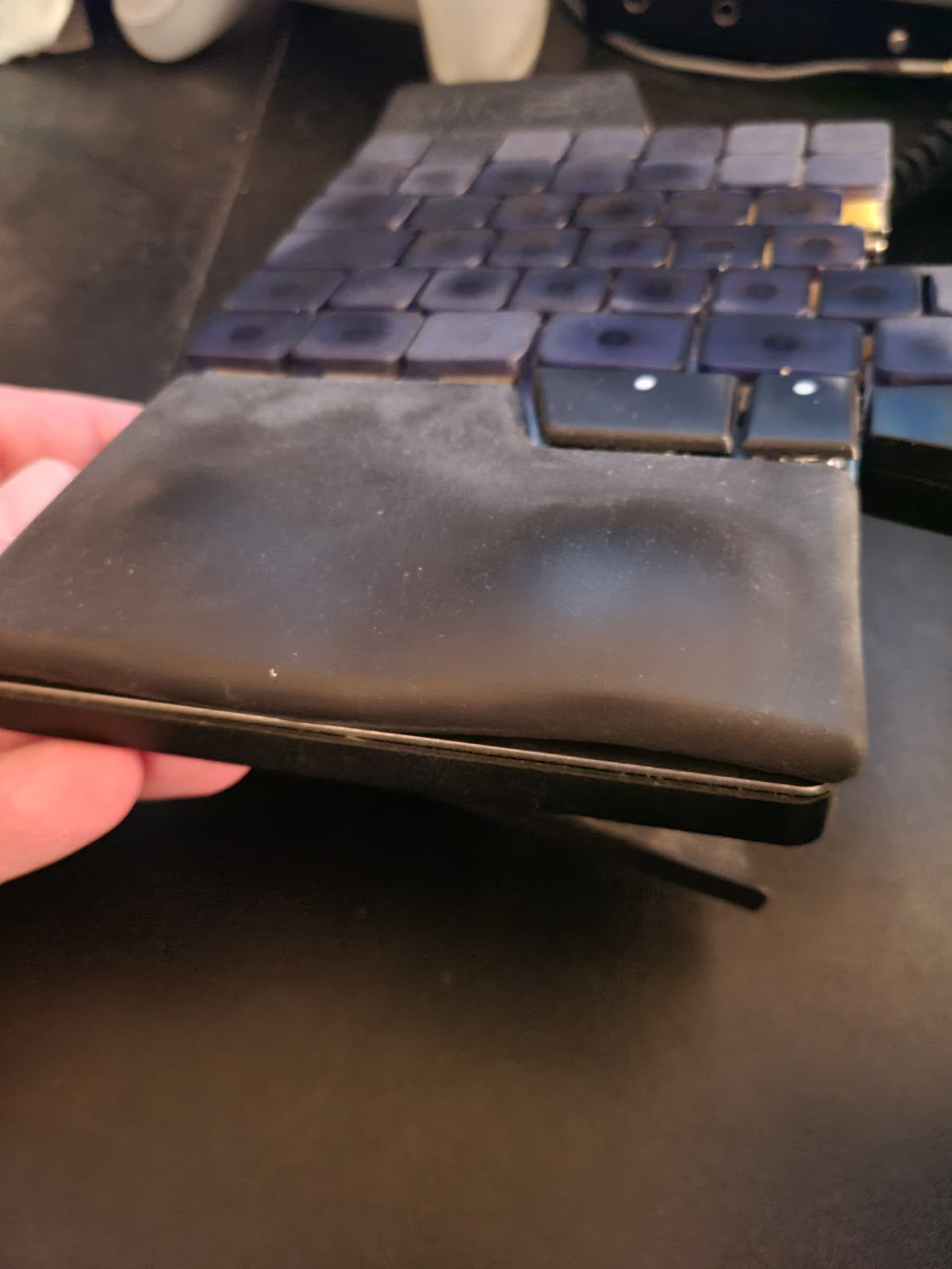

I’ll update this post when I get home with a picture, but I have this happening pretty severely on both halves of my alpha unit
I’m sorry for the delay as I’ve been swamped all week. I do not have the exact shipping date but I was one of the first batches after the wireless dongles arrived (ordered November, shipped around Feb iirc?). I don’t have any pictures as I’ve sent it back already for the board coil whine repair (to which someone has stated that they’ll replace the wrist pads when it arrives rather than sending a new pair). I do not think it’s a heat issue as mine developed on the right side as opposed to the left, where my hand usually will always be when gaming.
That’s beautiful and absolutely astonishing! You ain’t effin around man…

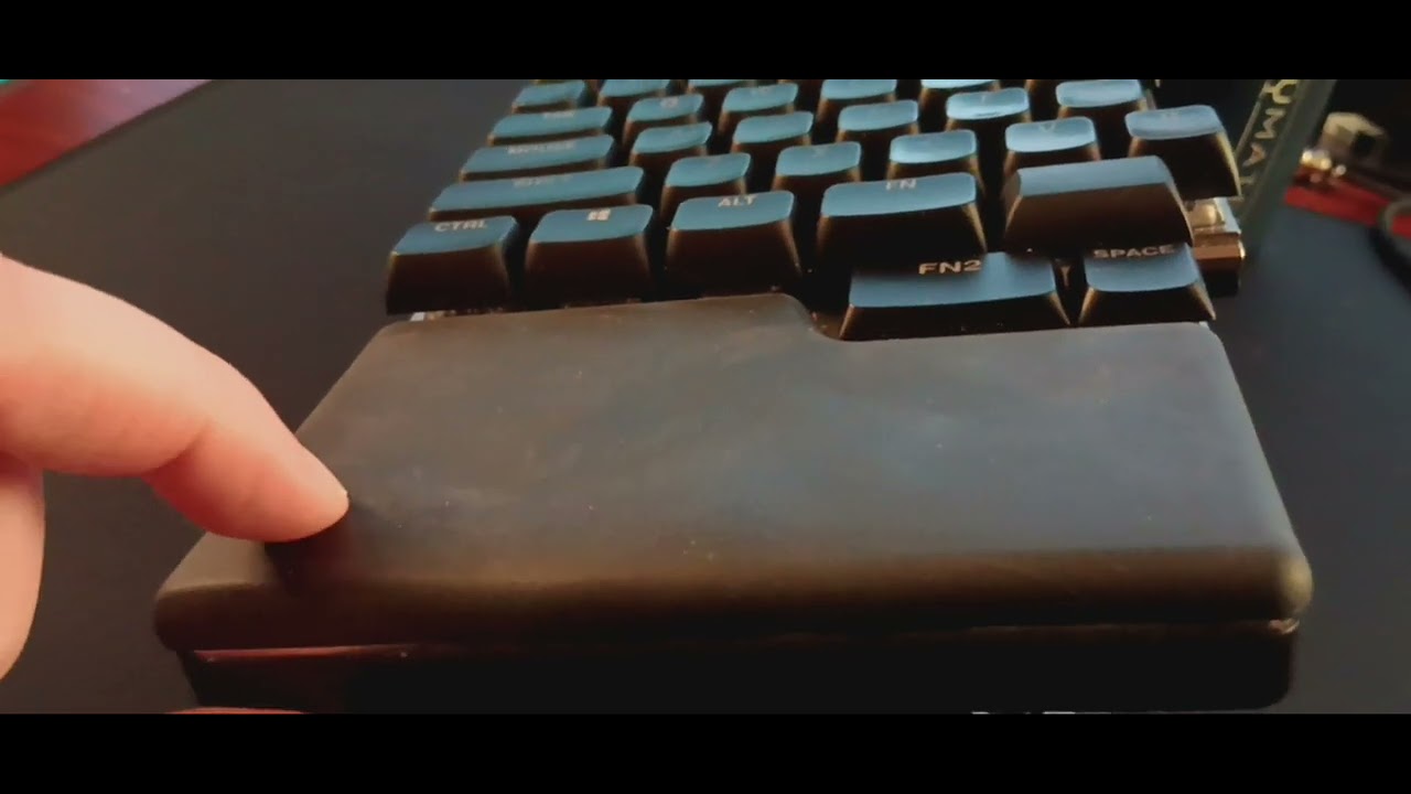

After seeing Zetaphor’s pics, I’m ashamed of myself for not abusing my UHK80 enough, but here’s a video of my bubble anyway…
