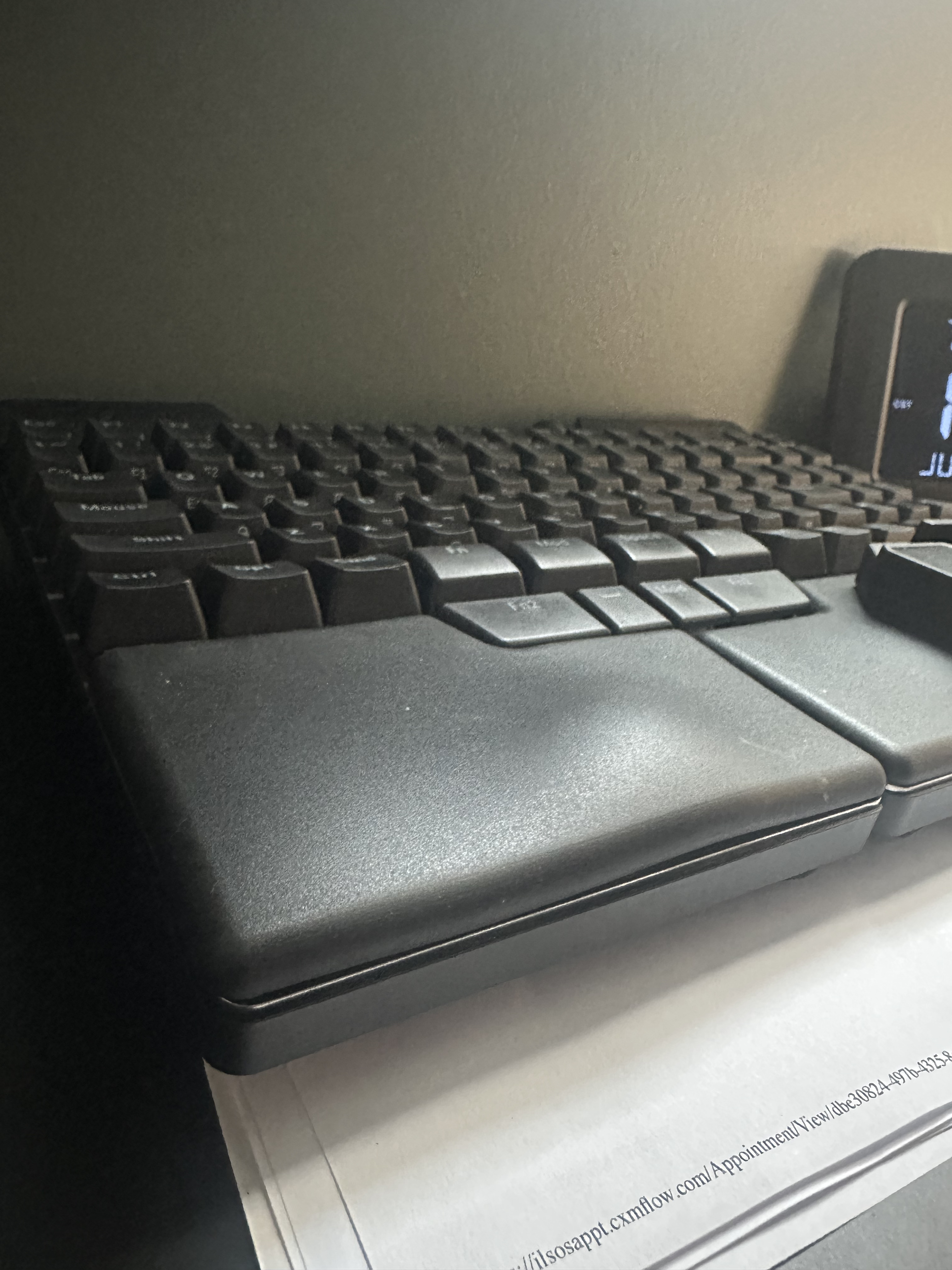

I have the same issue, though it’s pretty minor right now. It’s on my left hand side. I feel like I tend to apply more pressure on my left hand when I type. As I reach for keys in the upper left and right of the left side of the keyboard I think that movement is stretching the cover? It may only happen to some of us because we’re pressing down harder on the cover with our palms and others are only lightly touching it.
I noticed the battery cover rocks slightly when I remove the rubber cover and that may also be a factor? I don’t have batteries in mine.

It’s been about a month or two since getting my replacement pads whenever I sent the keyboard back for repairing the coil whine (which has been amazing and hasn’t come back, I’m so grateful). The bubbling up has begun again on the right side so not quite sure what else there is I can do to resolve this. I will note that it started the day after I spilled a very small amount of water on the pad (like the moisture from a glass dropping off as I moved it from one side to another), but I’ve also had water droplets fall on the pad other times and nothing happened so unsure if it’s the reason. Note: The right pad was the first to start bubbling up but now I’m starting to feel one on the left pad that’s just starting…

Mine has started to bubble up very slightly, not really noticeable yet but it’s gotten shiny and sticky. I’m betting the rubber used is being deteriorated by the oils in our hands.

Seeing bubbling on the left side (using plugged in without batteries). order 20484 shipped march 2025. The left side also seems to have been bricked with the latest update so less concerned about the rubber pad than about the thing actually working… especially since I have become completely dependent on my uhk layers / macros :frowning:
Not too bad yet. That looks like some strong double-sided tape will hold it down pretty well for a while…
