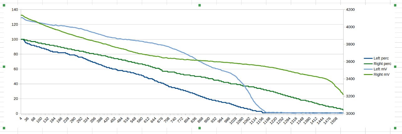

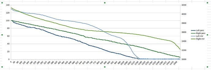

That’s because the limit is not 80%. It is 3800mV, which is the optimum storage value for LiPol batteries.
This is more nuanced for left half because of the different discharge curves of the two batteries. (Note where the top blue curve intersect right axis’s 3800 - around halfway to 0, which means that the storage voltage is much closer to 50% than 80%.):
