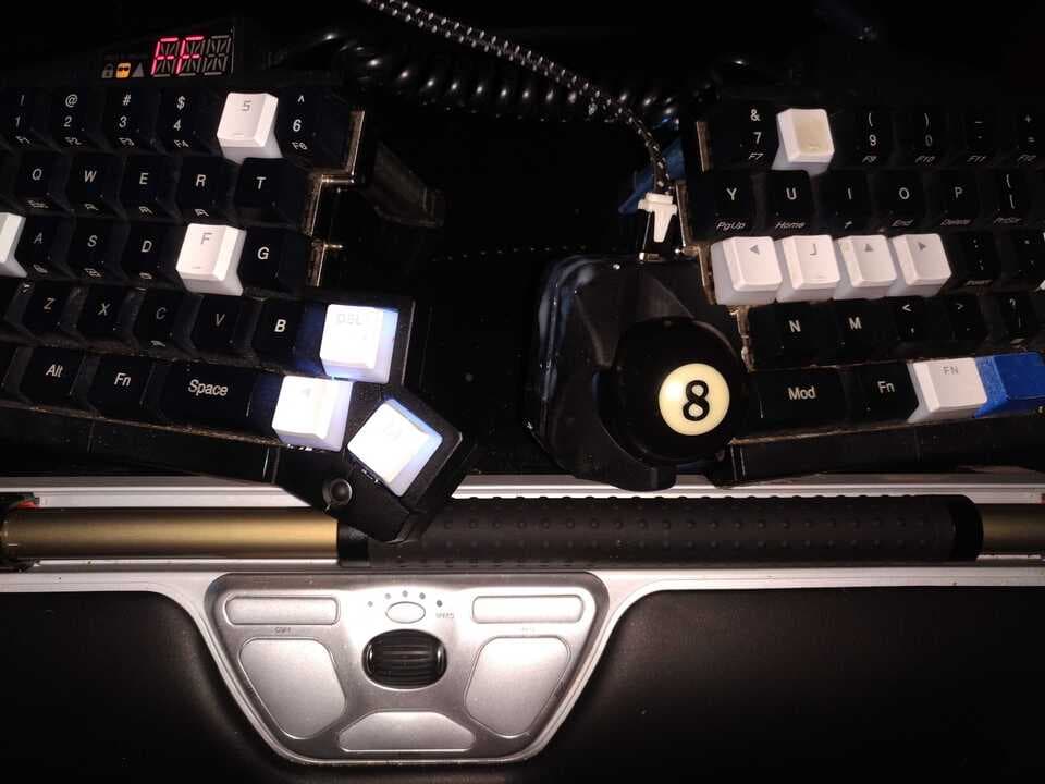

Usecase: Thumb Trackball
Summary
This is my main mousing setup. The main idea is that base layer 7890 keys are bound to mouse buttons, so the trackball module + 7890 keys act as a full-value thumb trackball.

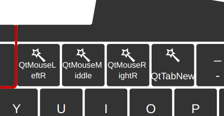

Details of the setup:
Base layer:
2024-02-03-120546_461x240_scrot
Mouse layer:
2024-02-03-120553_461x240_scrot
Macros:
// $onInit
setVar middleBtnTimeout 50
// QtMouseLeftR
ifShortcut timeoutIn $middleBtnTimeout 9 final holdKey mouseBtnMiddle
holdKey mouseBtnLeft
// QtMouseMiddle
ifNotNumLockOn tapKey numLock
holdLayer mouse
tapKey numLock
ifNotPlaytime 300 tapKey mouseBtnMiddle
// QtMouseRightR
ifShortcut timeoutIn $middleBtnTimeout 7 final holdKey mouseBtnMiddle
holdKey mouseBtnRight
// QtTabNew
tapKey LC-t
// QtTabClose
tapKey LC-w

My Ploopy trackball is programmed so that if num lock is on, it scrolls, otherwise it moves cursor. Furthermore, the middle button macro taps numLock on press and then again on release, so both UHK and the Ploopy trackball scroll when 8 is held, and control cursor otherwise.
Numbers
Clearly, this setup strips me of the ability to use numbers the normal way. But that is okay, my numbers are bound in homerow on fn layer (activated by right space):
-R / -L suffix
I have my ploopy on the right side of my UHK. For this reason, I also have similar macros (with -L instead of -R suffix) bound on 1234 keys.
