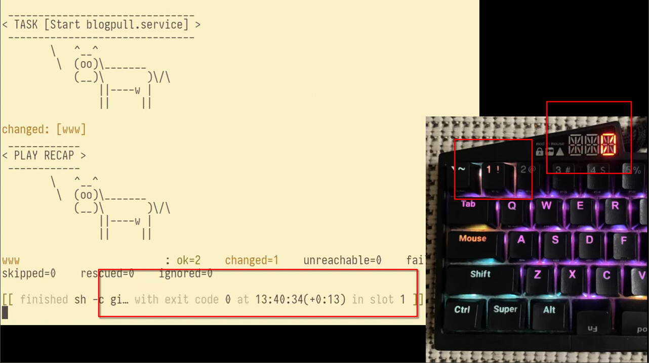

Wanted to show off one way in which I find the UHK’s extensibility super helpful (particularly regarding its ability to trigger macros from your computer). I wrote this blog post that tries to showcase and detail this, including a video of me using it; if a picture is worth a thousand words, than a video is worth a thousand pictures. And I’m not sure how good my words are at describing this ![]()
The uhk-related tl;dr is that I have a program (“wnl”) I use to improve my own terminal-oriented workflow. I use UHK macros to dynamically illuminate and de-illuminate shortcut keys, and to show terminal command exit codes on the UHK’s display. While I could still have the same overall workflow without the UHK, these elements add a whole lot of polish and usability to the setup imo. Love my UHK.
It’s worth noting that, if anyone is interested in a similar setup with wnl, it should™ be easy to get started with. The finer points of integrating with the UHK take a little more effort. I think I’ve documented them adequately in my blog post, but I could very possibly have missed stuff of course.

I put my number keys on a non-base layer, freeing up the number key row on my UHK60v2. Like I say in my blog post, those get bound to ctrl-super-shift-F{number}. Those are set to trigger their corresponding wnl slots, e.g. the 1 key runs wnlctl 1. By further mapping my backtick key to alt, I can also map backtick-1 to SIGNAL=USR2 wnlctl 1 to terminate whatever is running in slot 1.
Of course, this ability isn’t specific to the UHK, but applies more broadly to a remappable keyboard.
Macros
This is where the UHK really shines. Detailed more in my blog post, but I hacked things together such that:
- By default, all the number keys have their backlight turned off
- When I run
wnl(“binding a command to a slot), that backlight for that slot’s button is turned on. E.g. if I runwnl 2 make test, the number 2 key will light up - Whenever a command finishes running, that command’s exit code is shown on the UHK’s display. That code is shown until the next key is pressed.
The backlighting stuff is at its core relatively straightforward, using the set backlight.keyRgb.base.<key> macro. Whereas clearing the exit code from the display upon next keypress was harder; I needed to ask here on the forum for help.
