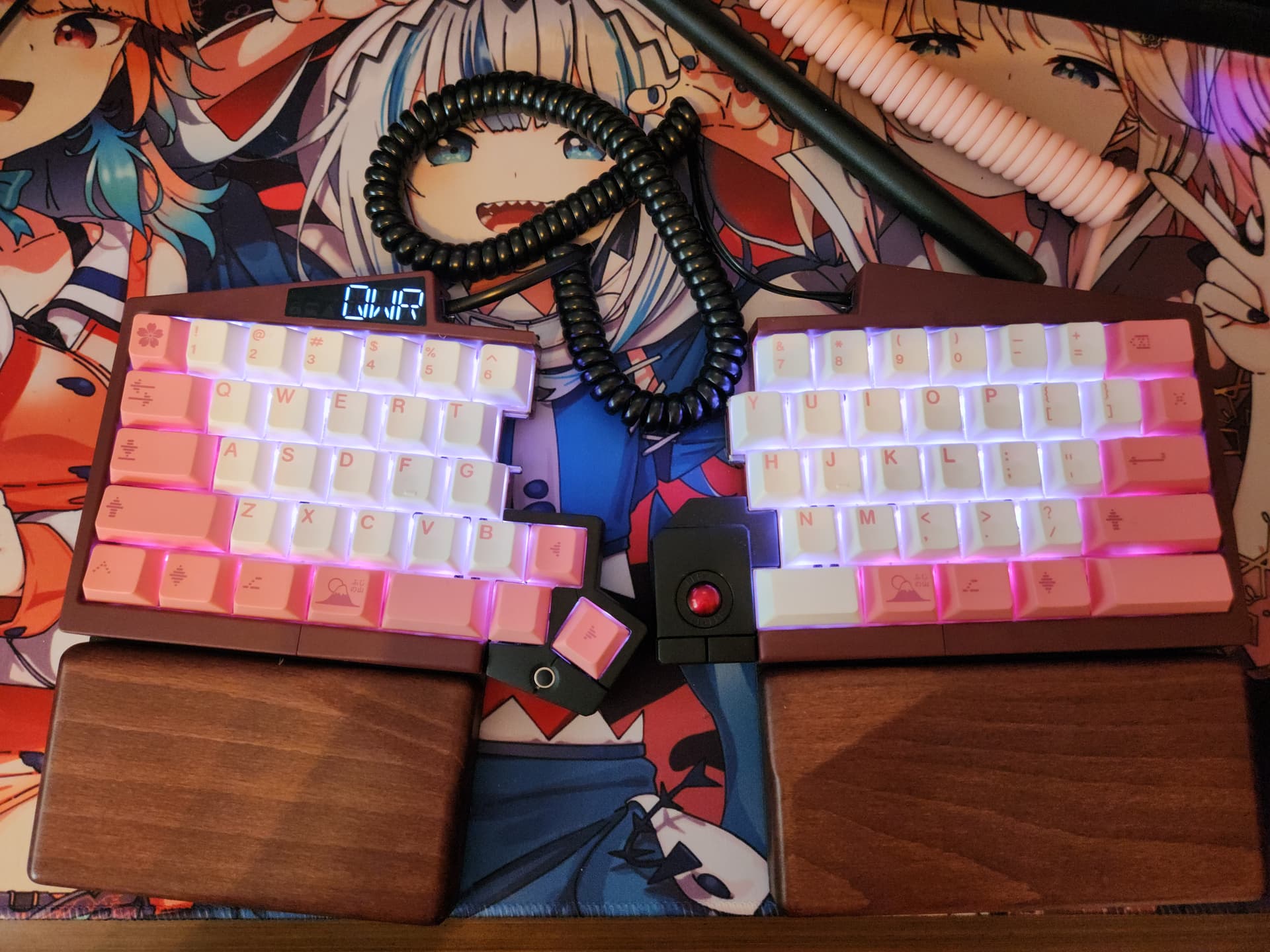

I bought JakeTsai Double Shot KeyCaps on Amazon.
nice! do you know what type of keycap the backspace is? It seems to fit perfectly
It’s a 1.5u row 1 key, incredibly hard to find. You can get 1.5u row 2 ā€œdeleteā€ keys more easily, but they are always just a tad off. I can’t quite see from the photo above whether their BACKSPACE was row 1 or row 2.
I assume the BACKSPACE is row 2 or row 3, I am unsure. So it does not fit perfectly, but I think it is okay.

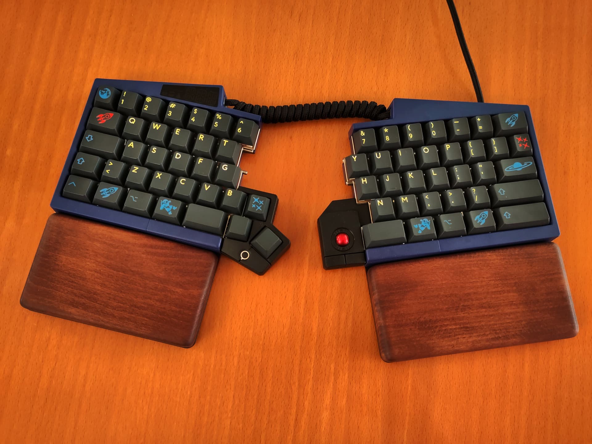

PBTfans Frontier works quite well on the UHK:
These are thick (> 1.5mm) double-shot PBT, cherry profile keycaps. This set has all the correct keycaps for the ISO layout except for the backspace key which is an R2 instead of an R1. Including an R4X 1.75U keycap for the spacebar and R4X 1U keycaps for the key cluster module in the optional 40s kit. However you need 2 40s kits if you also want a spacebar keycap for the mod key. Otherwise you can use one of the R4 or R3 1.75U keys. On the ANSI layout you need to replace the 3rd R4 2.25U keycap with an R3 one.
Isn’t Cherry slightly lower than the OEM profile of the original UHK caps? Do the modifiers feel slightly off from the alpha keys?
Yes, the Cherry profile is lower than the default OEM profile. Also the slope angle is slightly different on some rows. However I’ve replaced all keycaps with ones from the Frontier set, so they are all Cherry profile. So everything except the backspace key is consistent. The Frontier alphas have yellow lettering. In reality the yellow looks somewhat darker and more vibrant than in the picture.

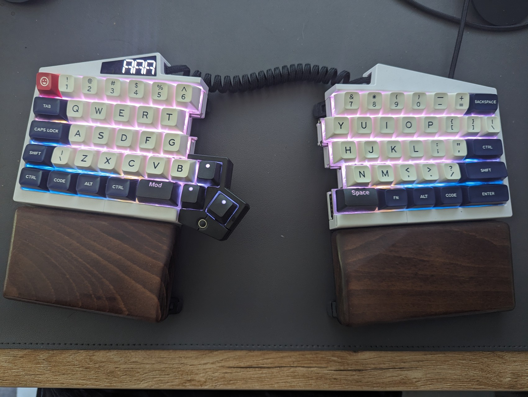

I love MT3 sets from Drop. If you get an Ortho set, it fits UHK almost perfectly
Ehhh… Close enough. Still looking for a suitable Backspace.

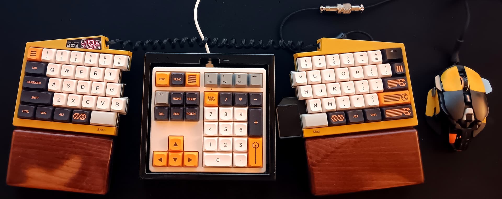

YMDK Virtual War ZDA caps (0.9mm taller than standard XDA) & some light grey XDA spacebars.
Are these uniform (same profile on all rows) like XDA?
Yes. Eyeballing them, their sculpt seems exactly the same, just a little taller.
