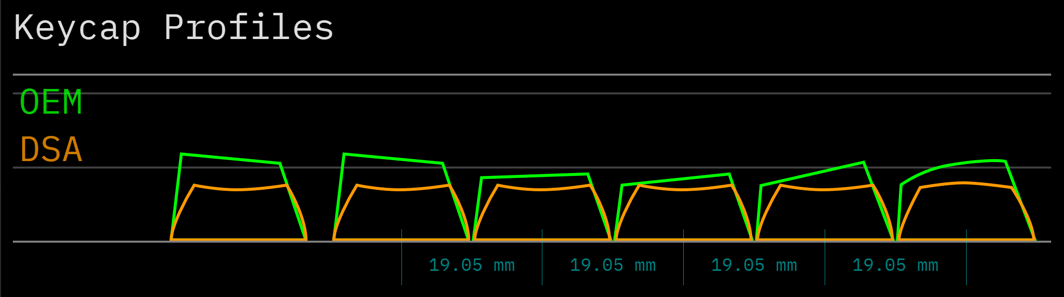

Like Karel said, you can use the alphas and maybe a few other caps from the set you linked to, but it’s also a good idea to mention that those are a different profile than what comes stock on the UHK. The UHK comes with OEM profile caps, and the ones you linked to are DSA. The DSA caps are much shorter and of a uniform height/sculpt, while the OEMs are different heights for each row. It’ll likely feel very awkward if you mix profiles.
Here’s a comparison of the two:
I took that image from a pretty useful site here: https://www.keycaps.info/

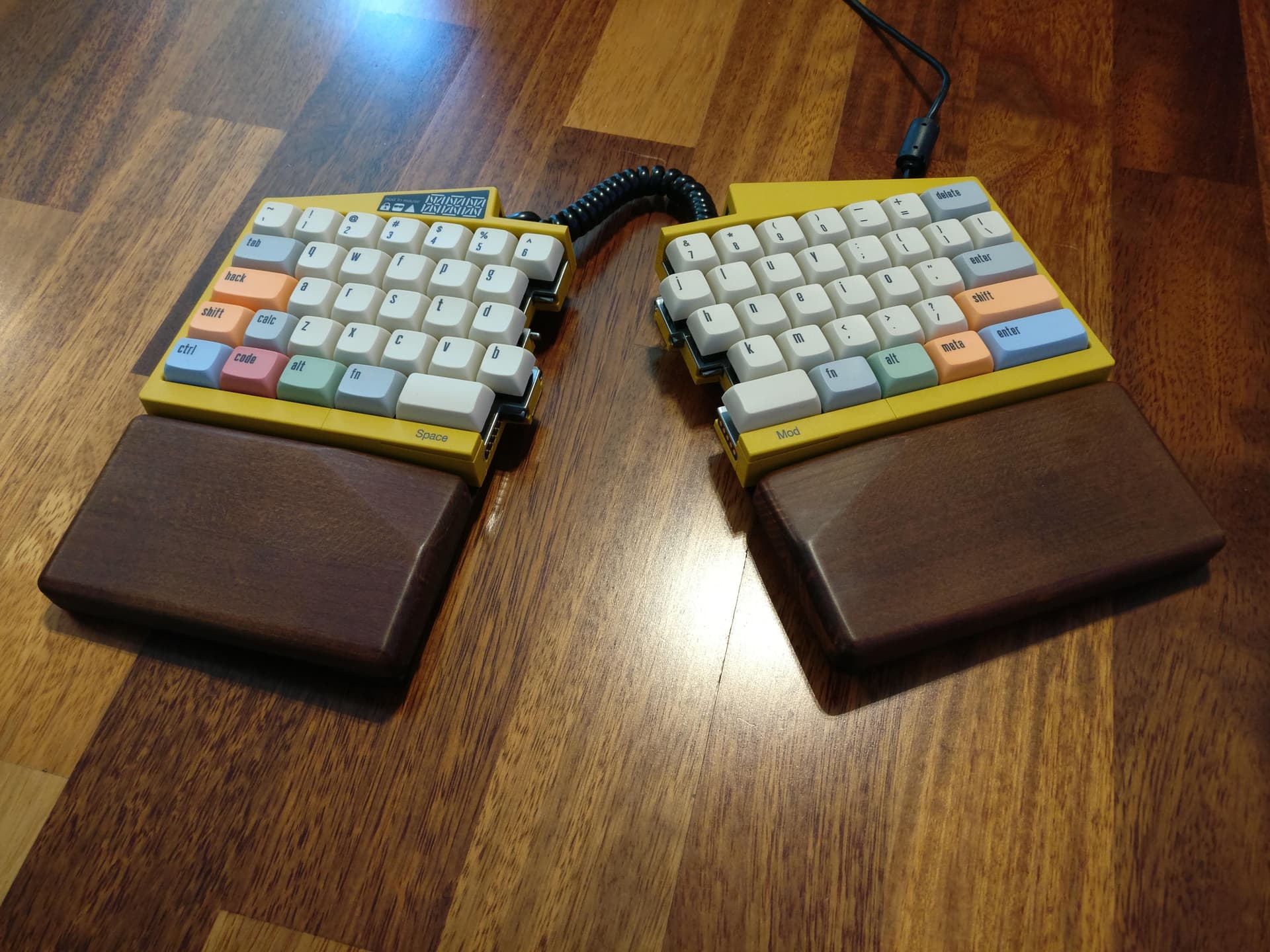

My story about finding keycaps for the UHK and eventually getting caps from Yuzu was featured on a UHK blog post a little while ago: Custom UHK keycaps available - Ultimate Hacking Keyboard

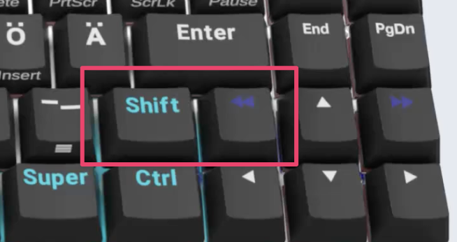

I recently got UHK80 and one thing I definitely missing compared to UHK60 is wider right shift. There is a key next to it (:rewind:) that I don’t need and I wonder if I can get a keycap to cover both switches like so:
i
IIUC, it would be 2.25U keycap, but it doesn’t look like I can use any because of the placement of the switches. Is there any solution for that? Or is my only option is to 3d print it?
(sorry if it’s the wrong thread, seemed relevant)
I know 2u POS (point of sale) style caps will fit over two 1u switches, but I’ve never seen anything similar for 2.25u switch spacing.

I didn’t like the shorter right-shift at first either. I got used to it pretty quickly though. I have to admit, I looked for a cap to bridge over the same keys as Rusty for the first week or so of using the UHK80.:sweat_smile: I ended up just mapping “none” action to the double-arrow key until I got used to the shift. Now I love having those double-arrows there. I use em all the time.
