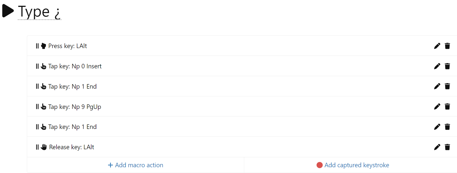

Here is a macro that types a ¿
You need to bind this macro to the key which you want to produce the ¿ character.
Based on @maexxx’s post, following should do the same thing: tapKeySeq pLA np0 np1 np9 np1 rLA.

Thanks! Both worked a charm, I was stupidly including an explicit numlock press before and after!
