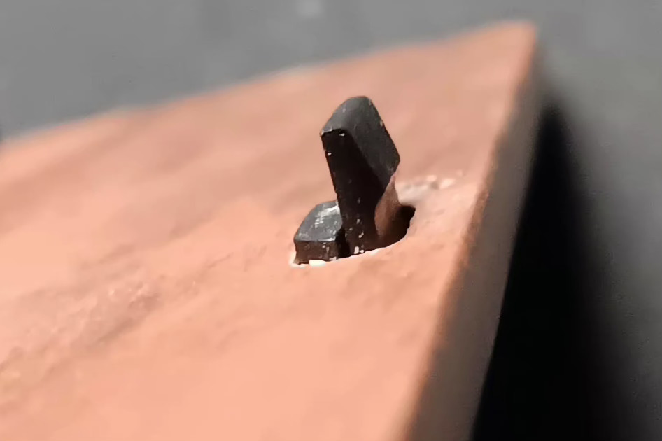

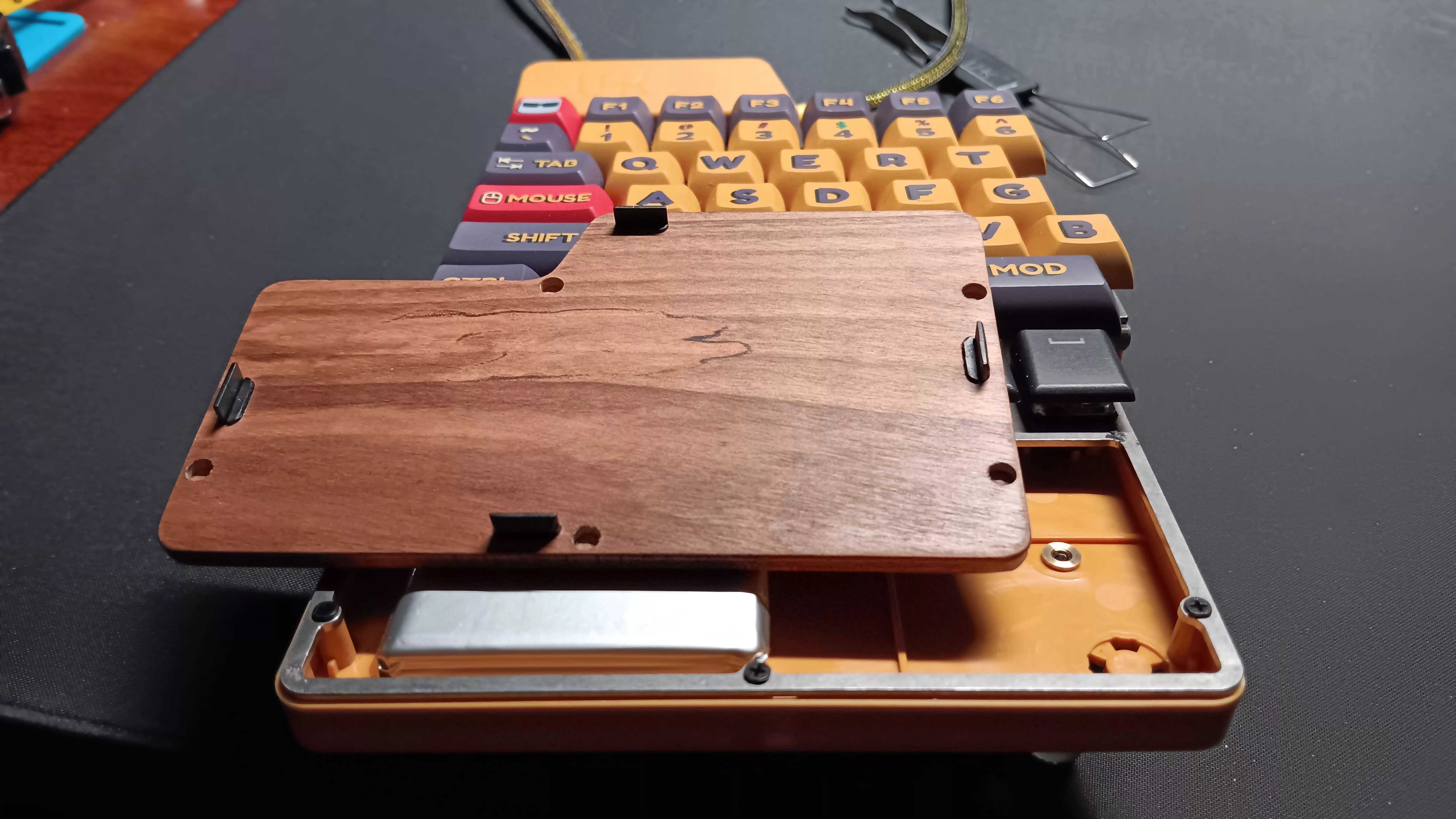

This is how the UHK80’s new wooden palm pads attach, btw. They’re held in with little plastic retention tabs. I was kinda hoping they would have some sort of plate with tabs built in, and then the wood could be screwed onto that (similar to the UHK60). The wood would probably end up a little too thin/brittle that way though. I was hoping I could replace the wood with leather, but :man_shrugging:.
Idk if those tabs would be strong enough to support an extended version. They’re more than sufficient for the official pads though. For a larger size, you’d probably need to make a lip/brace to hang over the bottom edge of the case. (You’d likely want to for aesthetics anyway.)
@kareltucek It’s hard to tell from the Etsy pics, but it kinda looks like your extended pads might have a bit of an overhang? Do you think using similar tabs would be sufficient to hold your extended version?

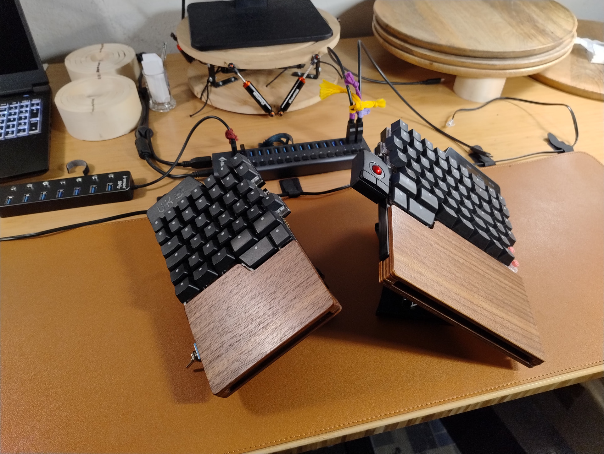

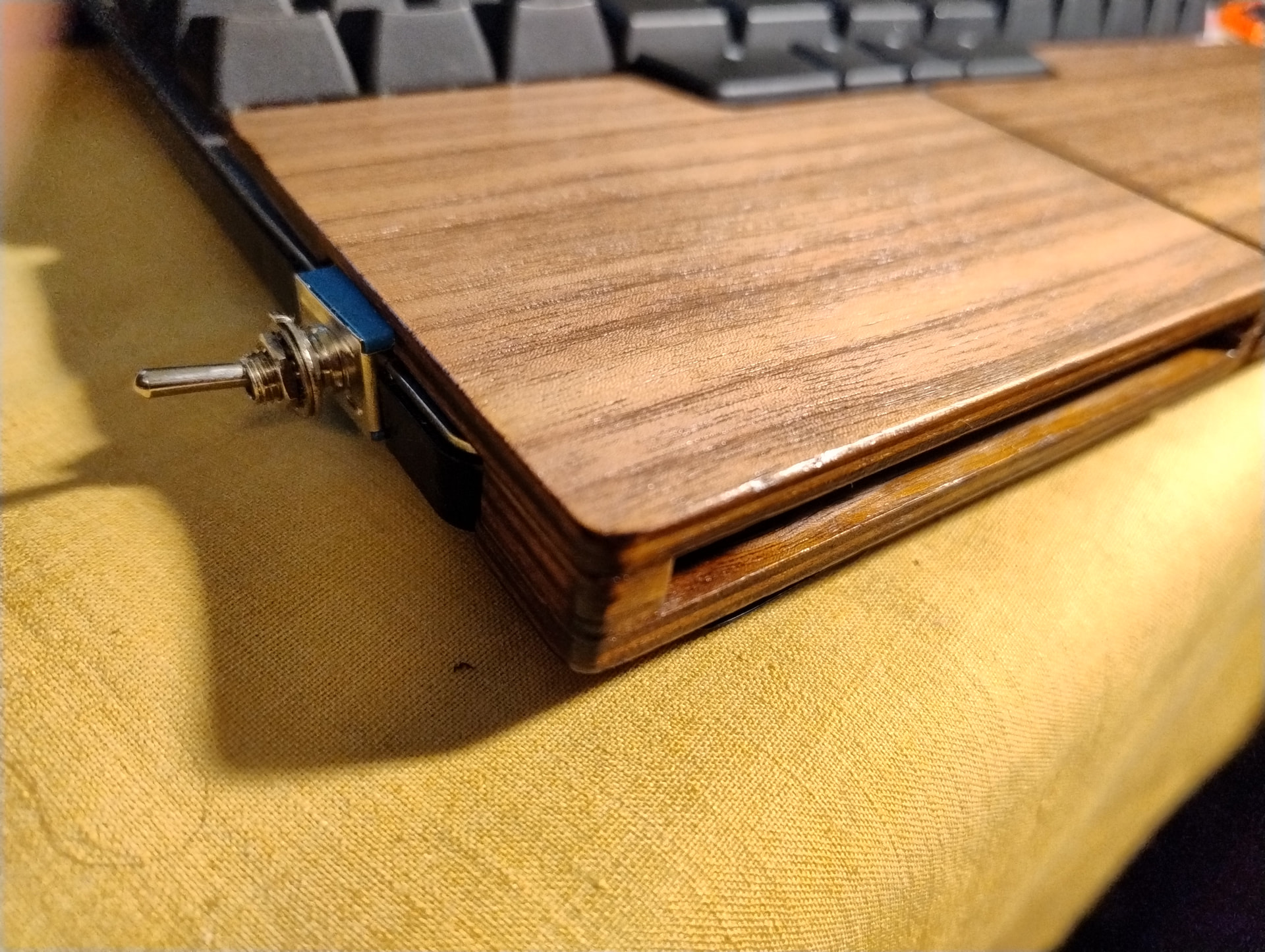

Overhang: yes. It is 2 cm, with another offset bar to not look too weird or diysh.
As for tabs, I don’t know - I don’t have any of the new palm rests. I wouldn’t trust one in the middle of the top edge. Two or three would probably be fine though. I don’t know if 5mm is thick enough to install them either.
As for attachment, I have finally decided to actually modify and install them onto one of my uhks, so we will see. Given the lever ratio (the overhang 2cm vs the 7cm that are supported), a surprisingly little force is needed to keep them in place.
I am open to US shipping, but so far didn’t bother to figure out how to do that, especially not in a way that would be reasonable w.r.t. customs, taxes, etc… and given that, it doesn’t seem fair to list it on a buy-with-a-few-clicks platform. So atm it is on a per-customer-agreement basis I guess.

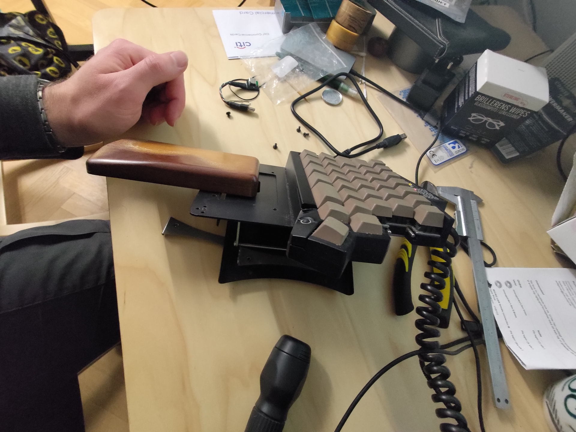

On the 60, the screws can be redone any number of times no problem. Definitely not a one-shot situation. The rests have a metal back plate with holes in them through which screws screw into the wood. If you make your own rests, you can choose the screws and the holes into which they screw.

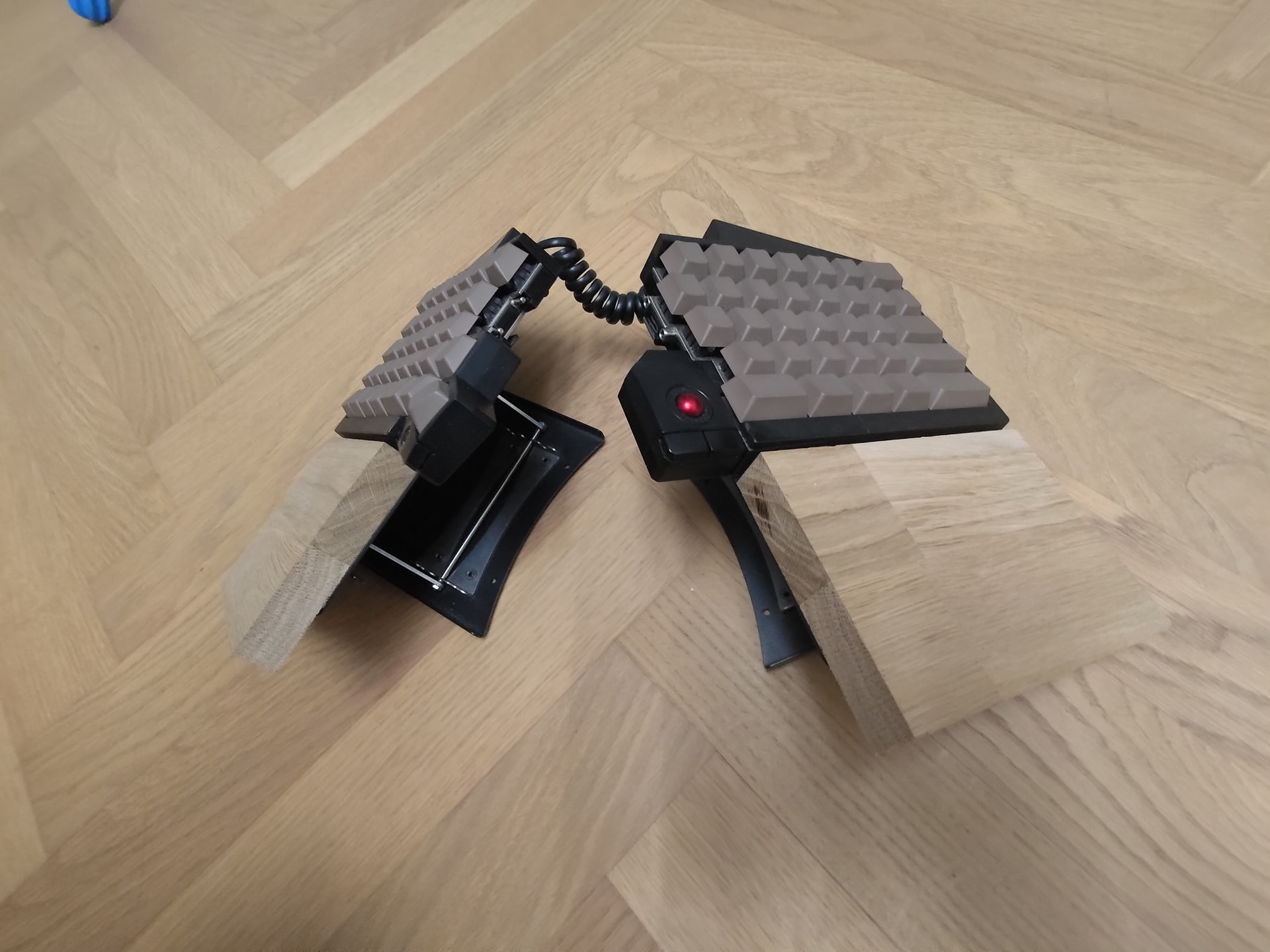

Just for testing, just now I rotated one of the wrist rests and tried a comically long rest. The cantilevering is real, and I would not recommend this 8.5cm extension, but if you get the riser, it has a bunch of additional holes for adjusting the angle, and I would see it as pretty trivial to attach a stabilizing piece of steel. The steel would have to be pretty solid though. Or if you’re willing, you could just add an entire additional bottom plate/board, though that would add height, and with the riser, it’s already a pretty tall contraption. Alternatively, it’s possible to go all-in on making your own riser, such as this example: Module template CAD drawings - #10 by monguin
Here’s a picture of this morning’s experiment

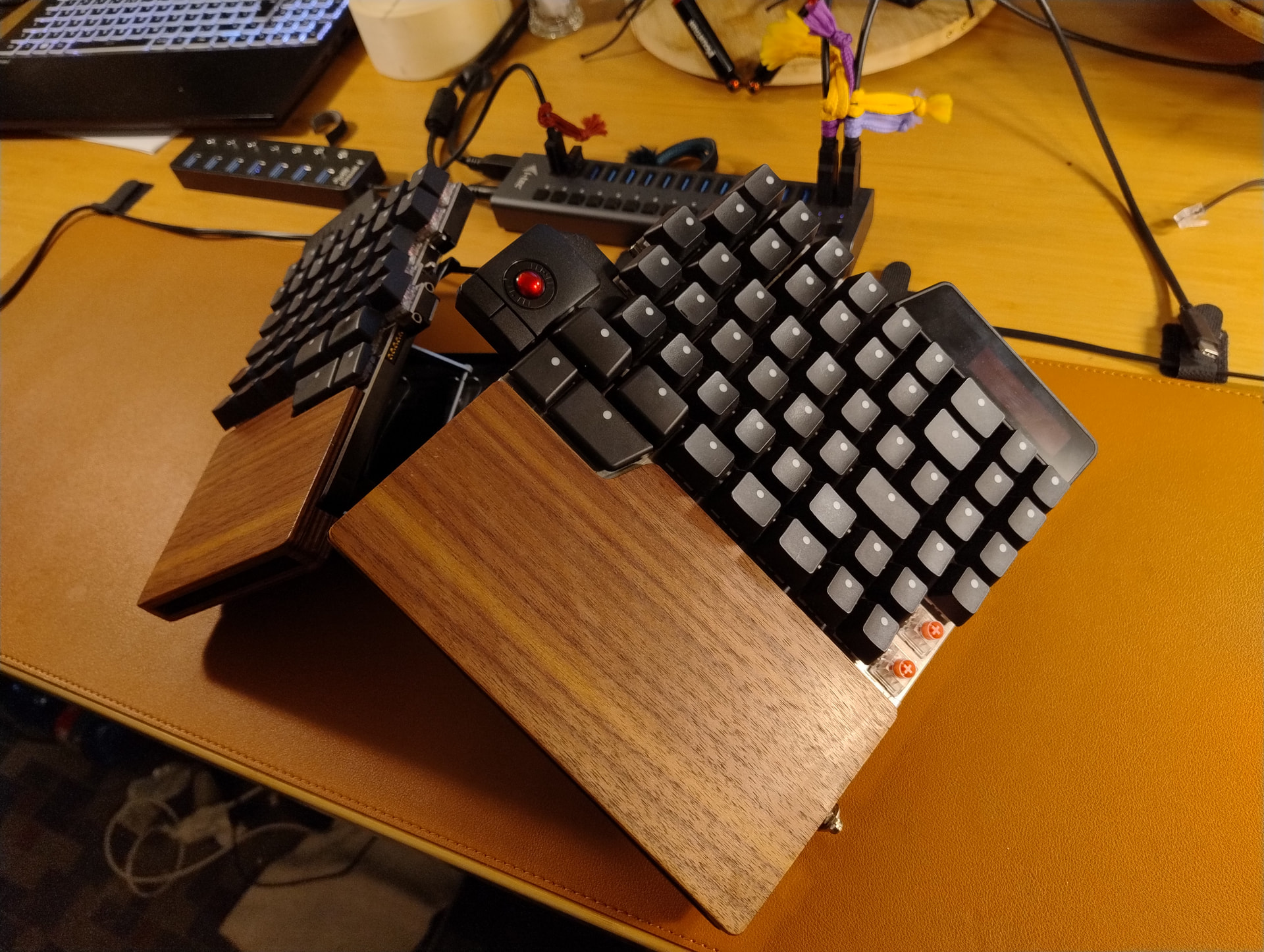

Yes - I sometimes have a tendency to rest my elbows on the uhk and lean on it with my full weight…
Looks even better than I expected. I like the little open spot in the front. I’d love to get an extended cherry version, but I’m “tariff-ied” of the potential extra fees :smirking_face:. I’m also in the middle trying to build a new PC at the worst possible time :roll_eyes:.

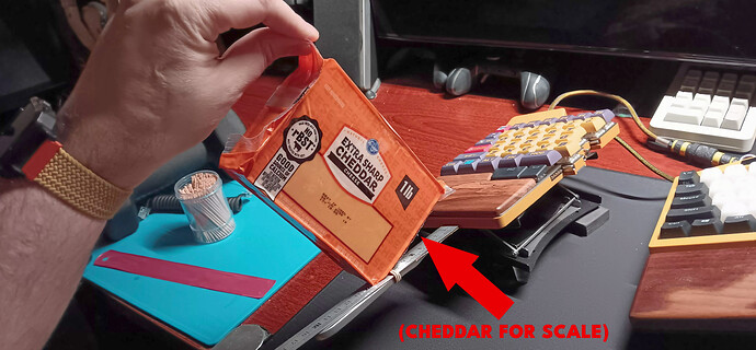

Here at WTH-R-U Doing Labs, we take measurements VERY seriously.
The science is in;
In order to cause the UHK80 to tip toward the user, roughly 16oz of cheese, spaced at an additional 9cm (approximation) beyond the bottom edge of the palm rest is required.
(This kinda feels like it could’ve come from an xkcd comic that ended up on the chopping block.)
Seriously though, it doesn’t look like tipping is gonna be a problem.
Oh, in case you’re questioning my methods;
  1. Yes that’s a ruler strapped to a cheese knife (proper tools for the job).
  2. Rest assured, I did in fact stick out my pinky finger while balancing the cheese. (Sorry I cropped that out.)
(Source: xkcd: Metric Tip)

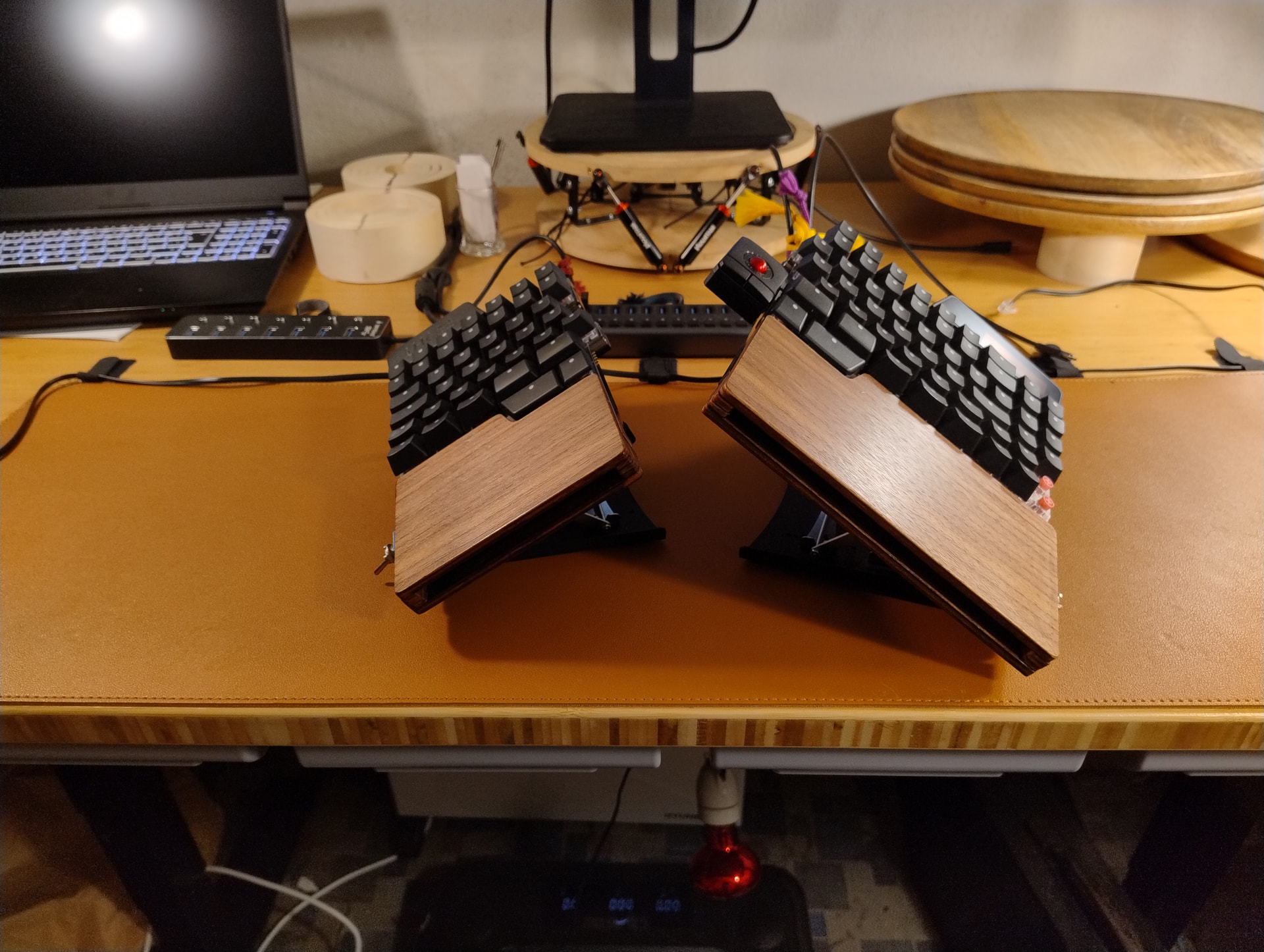

After a first day of tened use of the uhk80 2cm extended ones, I can confirm that they are stable with no issues. Simple double-side-nanotape solution works perfectly, even despite this version having only 1mm overlap instead of designed 3mm overlap on the (critical) top edge.
(Yes, I fell in love them pretty quickly.)

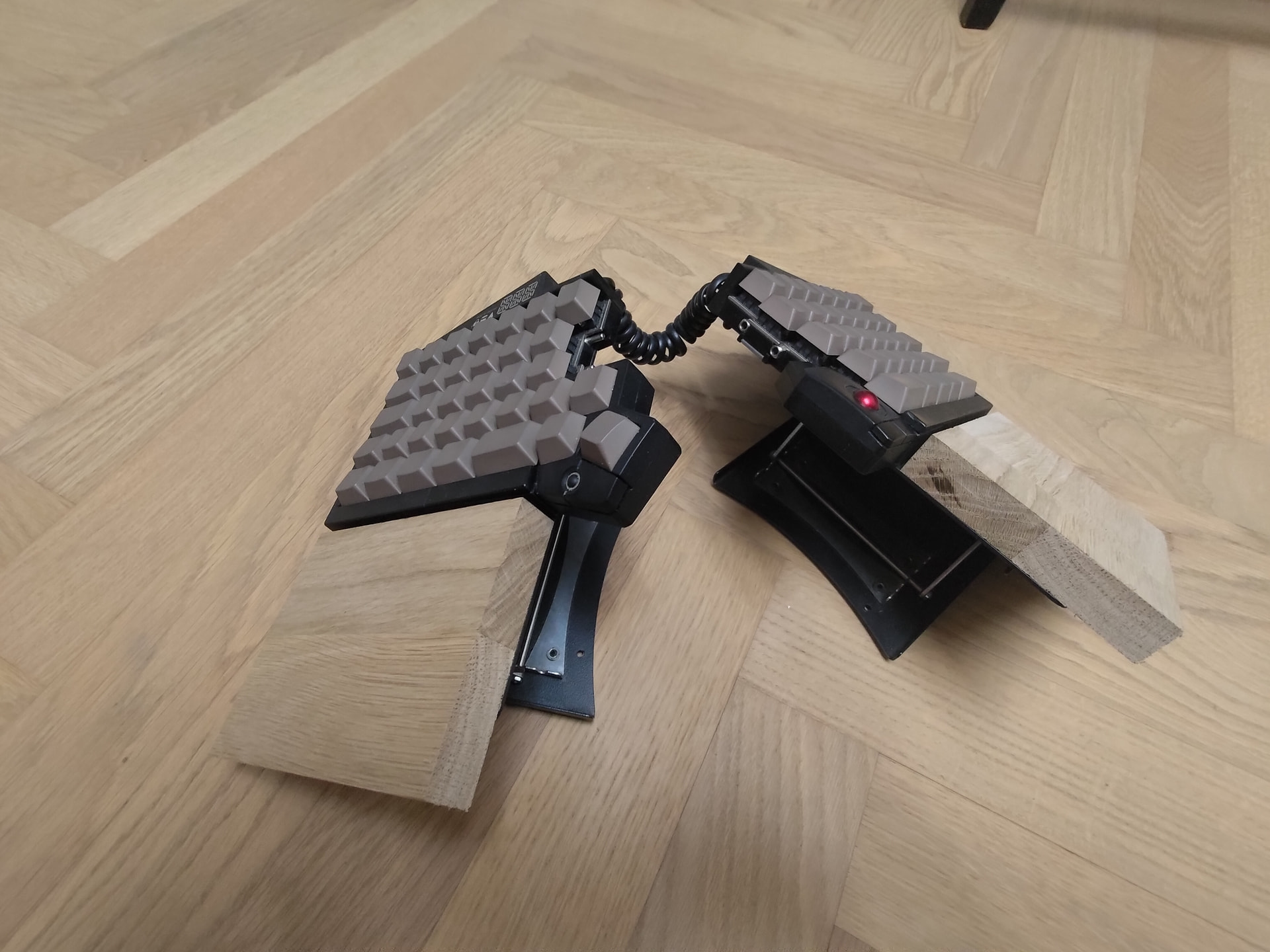

10cm isn’t too far off from the original 7.5cm, so I wouldn’t worry too much about tipping. I happen to have some oak leftovers in pretty much the right dimensions lying around, I could try chopping a couple of blocks off to see how it works.
Ahhh, I see I misunderstood this:
That was for 8.5cm BEYOND the frame. :rofl:

9.8cm wide, 1.8cm thick. Slightly tippy. Right at the limit. Comfy though, if I rounded the edges and lowered the thumb corners. Doesn’t have the slight wedge shape of the official blocks.
