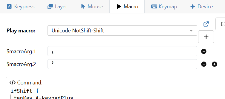

Anyway, I now have a macro that takes 2 parameters: A unicode character to send on unshifted keystroke, and a unicode character to send on shifted keystroke. I map it to a bunch of keys on a new layer and I can type (preselected) unicode characters pretty easily. I currently have the superscript/subscript digits mapped, and also some unicode “lookalike” substitutes for :, ?, / which can’t be used in filenames on Windows but which I want to put in filenames (to properly name academic papers which frequently have these characters in the title.
The macro looks like:
ifShift {
 tapKey A-keypadPlus
 delayUntil 100
 suppressMods tapKeySeq backspace backspace backspace backspace hexCodeOf(&macroArg.2)
 suppressMods tapKeySeq tab enter
else {
 tapKey A-keypadPlus
 delayUntil 100
 tapKeySeq backspace backspace backspace backspace hexCodeOf(&macroArg.1)
 tapKeySeq tab enter
and an example mapping looks like:
