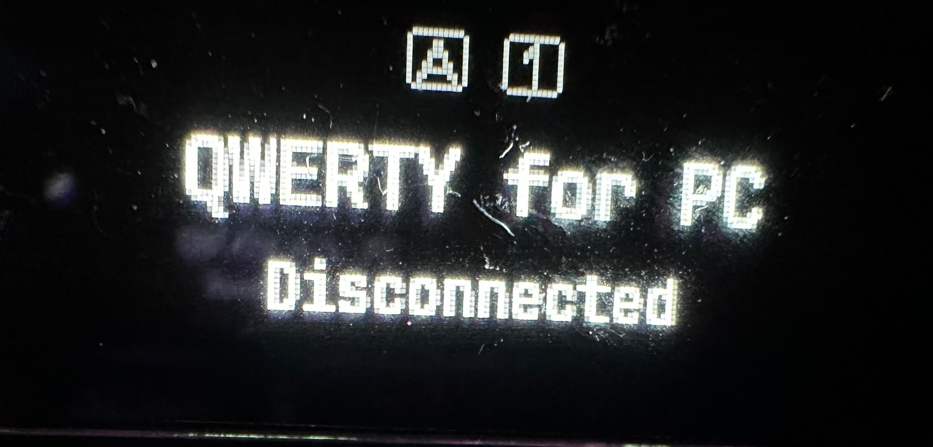

I got the UHK80. When I turn on the PC first time in the day, the keyboard doesn’t wake up, though it is connected with USB cabel. Its screen reads “disconnected” and I have to re-plug the USB.
I’ve updated to firmware 12.1.0 but still have the issue.
